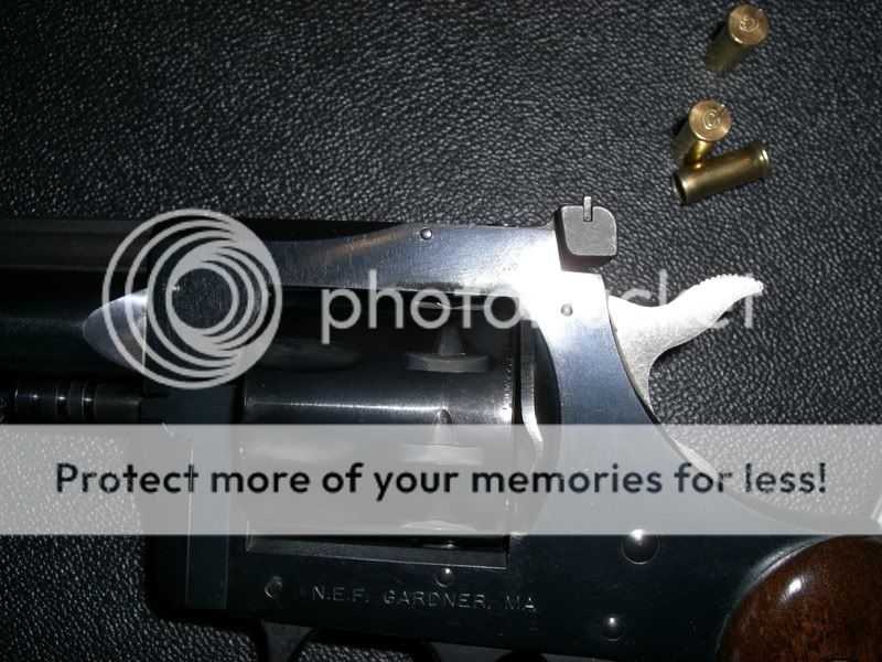

I just bought a New England Revolver from a fellow CGN'r and have a fwe issues with it. First, i noticed that the trigger pull is abnormaly heavy, the heaviest i've ever felt to be honest. If i had to guesstimate i would say somewhere like a 20lbs trigger pull. In single action, the trigger will be loose right until the last couple of mm of pull, but that last pull is very, very heavy. That was my first issue. Which i am sure can be rectified by someone in the know.
My second problem is when it comes to extract the spent casings. This is my first swivel cylinder revolver so im not really sure if this is normal or not. But when I push inward on the extracting rod to push out the casings, it seems the rims of the cartridges have been hit so hard from the firing pin that coupled with the casings expansion, I can't budge the extracting rod. I end up having to use a seperate rod to punch out the cartridges seperatly.
I have no idea if both problems are related or not. I think all i would need to do to fix the extracting problem would be to file down the firing pin a little so it doesn't hit and deform the rim of the casings so much. But, doing that would not solve the trigger pull problem. :bangHead: Hopefully one of you gunsmiths can give me some pointers on what i should do to fix my baby.
Ill post some pics so you can maybe see what im talking about.

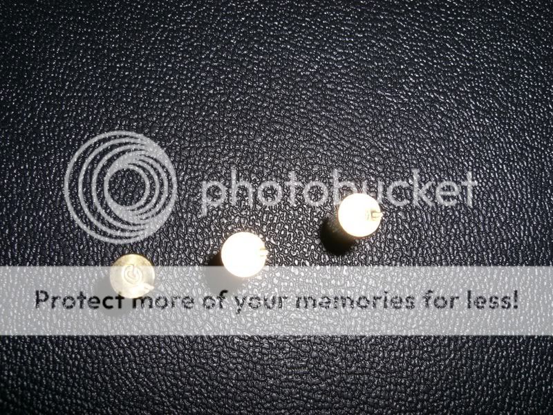

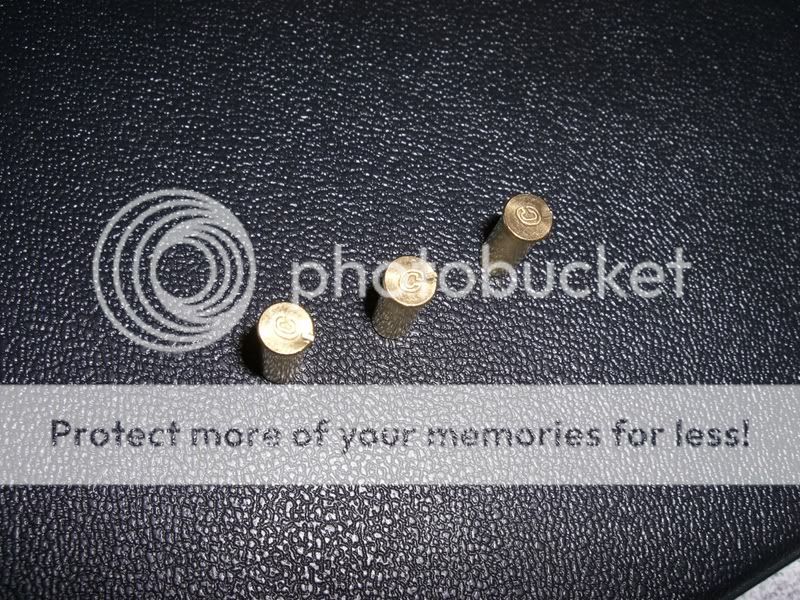

- These pics shows the dent left behind on the casings from the firing pin. I've never seen such deep dents on a rimfore before.

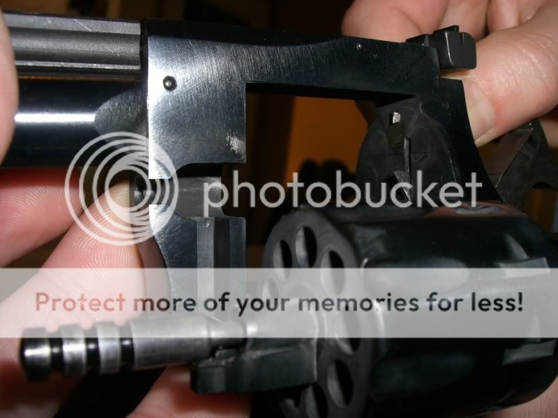

- In these pics i'm trying to show how much the firing pin protrudes out from its housing.

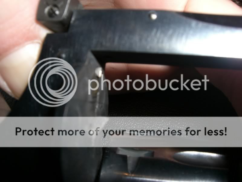

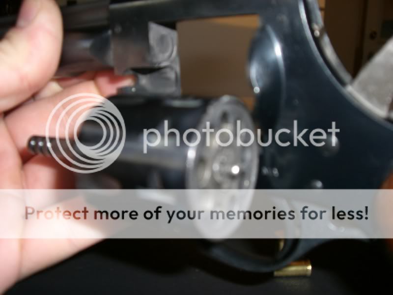

- This is a crappy picture in which im trying to show how big the cylinder's edge "lips" is. Once a cartridge is placed, the rim sits pretty much flush with the lip.
- Pic of the cylinder closed to show the gap between the cylinder and the frame.

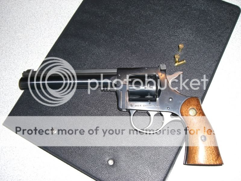

- Just a pic of the revolver in all its glory :D
Hopefully the pics help out a bit, at least letting you know what model and frame we're looking at. Any help would be greatly apreciated. thanks for reading.

Have you had it stripped down at all? The firing-pin indents don't look out of the ordinary, but sticky extraction is, so a good cleaning would probably be your first step. If there's a way to adjust the mainspring tension, it should be apparent if you take off the grip panels.
I cleaned her up right before taking her to the range. After all 9 of the casings are dented and warped, it makes it impossible to use the extractor. I have never taken her apart. Not even the grip panels. Ill check that tomorrow. So if there is a mainspring adjustment, what would i be looking for and doing?
Most of these types of revolvers are a little bit sticky when it comes to extraction (after all, you're dealing with 9 cases instead of the normal 6), but you should still be able to pop them out by swinging open the cylinder and giving the ejector-rod a smack with your off hand. If there is an adjustment inside the grips, it should be a threaded screw that can be loosened/tightened to give less/more tension against the mainspring. Alternatively, the mainspring might be rubbing against the insides of the grip panels, or you just might have a bunch of grit and grime built up inside the lockwork; it's impossible to tell without seeing it first-hand.

I just checked mine and my model does not have the option to adjust the mainspring. The "Stop" sits at the butt of the grips. I think she's gonna need some fine tuning as in a bit of filing here and a bit of filing there to make her shoot the way i want. Don't get me wrong, i love the pistol, she looks great and feels great. Nice heavy bull type barrel. I just need to lighten the trigger up and adress this extracting problem somehow.
Cheerz
To be honest, the firing pin looks fine :confused: the only thing that could be wrong with is it being a tad too long whichi is an easy fix. But everything is stock so putting in a new firing pin would just end up doingthe same thing. Unless they shortened it since production.
Last night a lubricated the mainspring with Hoppes 9 light gun oil and also lubricated all the mechanism's and gave them a little work out. Took a few shots to see if it wadea difference in trigger pull and it did seem to be lighter! Still a bit tough but seems much better then it was. I'll know for sure once i have time to try it out for a while at the range. The extracting problem is still there. So, if there isn't any other ideas about why this is happening, and if my lube job helped, im just going to go ahead a file just a tiny bit off the tip of the firing pin which should solve the problem. :D
