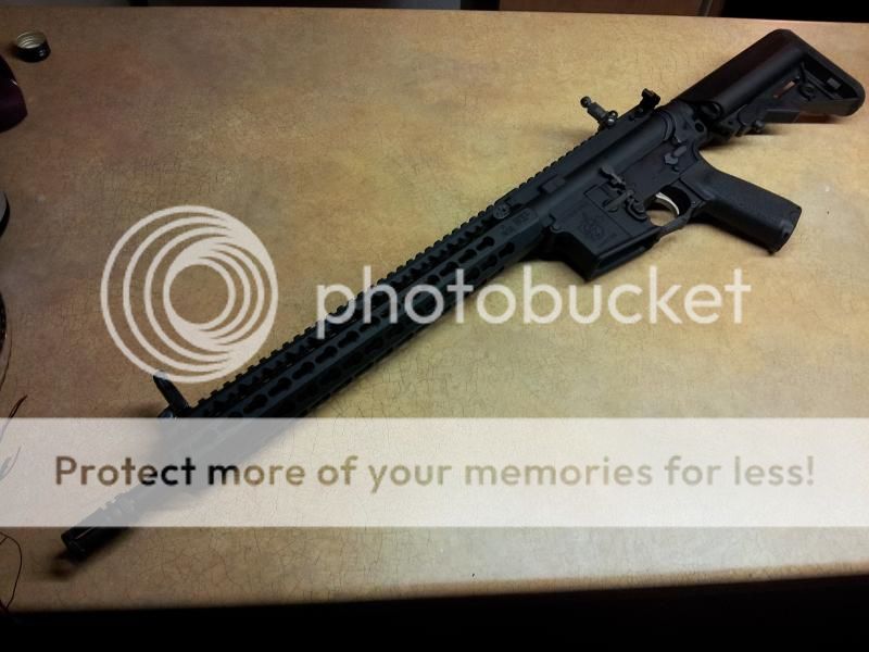

Get the BCM KMR-10. 6.3oz with barrel nut - lightest out there.

Agreed. Although I did run for the KMR and it was totally worth it. = )
