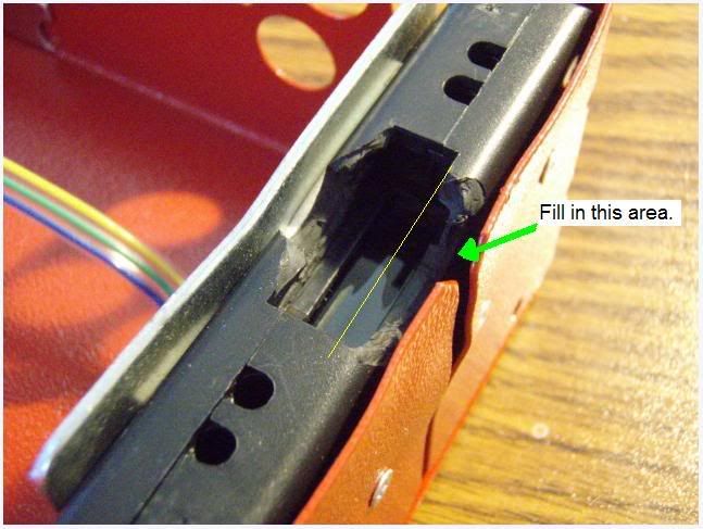

I have a Chorny but shot at the second sensor with a pellet, the black plastic housing was protected with a thick metal plate but I'm not sure if the impact of the 950fps .22cal pellet may have jarred the internals. I did a visual and the internals "look" fine, battery is brand new and the case open fully when I used it today.

How much damage to the Chrony? Can you show a picture? If the black plastic is broken it might be letting light (actually shadow) in early or late that is triggering the sensor.

What do you think... is it bad enough to cause a read error for the velocity?

Gosh, that is a big chunk you knocked out. Don't really know if it would cause problems or not. You could try carefully taping over it, to more or less duplicate the size and shape of the original viewing port, and see if that makes a difference.

That will do it alright. The chrony basically waits for the end of the bullet shadow to pass. So without that plastic it still "sees" the shadow till the bullet has gone much further. Everything should read low.
Now if you really try hard you might be able to repair it yourself. You have to replace the plastic you removed with something else that will block the light. And it has to be straight right where the edge was. See this picture:
You should be able to take it apart and just work with that one piece of plastic thus making the job easier and preventing anything from getting on the other parts.
If you go to Revy or maybe Home Depot you should be able to find some kind of gunk to fill it with. When it is hard cut or file a new edge right where the old one was.
I don't know what a replacement part will cost but if you do it yourself you don't need to wait for it.
I hope this helps! Keep us posted! :D
PS - did your Chrony come with that metal protector in front of the sensor? Mine didn't.

I live only a 45min drive from Shooting Chrony in Mississauga. Not only did I shoot out the housing but I also nick the wires so I had to do a quick fix but because the wires are so thin I didn't solder them but twisted them together and then shrink wraped each wire. I'm going to get the replacement parts that I need and that way I know all is working.

I shot out the housing as well as the plate with my AirForce Condor at about 3 feet away.... 950fps with a 21gr .22cal pellet.
