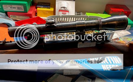

..... It has a very cool Weaver pivot mount 3X scope that is clear and well centered. (Weaver K3 60-B El Paso Texas) ....
Also, does anyone know much about this Weaver mount? It looks practical as it allows you to instantly revert to iron sights for close range zombie attacks.
Any thoughts?
Marty
That mount. I used to use one. Like most others of that type - two pointy ends into two divots - so periodically needs to be checked that still snug. Also, in use, from past experience - make sure scope is actually snapped down all the way on those mounts!! To watch for - not sure level of recoil on your rifle? Many shooters have their head not straight to rifle when shooting - left side of forehead further ahead - so that is where that scope is going to get "rolled over" to - so can catch a "scope bite" when using irons - depends on your shooting style, holding style and level of recoil - something to be aware of if you have not used them.
That scope - I am pretty certain the Weaver 60-B were "permanent centre" type - cross hairs going to always be centered, I think. But definitely was an issue from that era - not all stayed centered, for sure. But I think the Weaver 60 did. Do not think they were sealed though, so might be subject to internal fogging? For many years, a Weaver K3 was the scope on the #2 deer rifle that was here - I think it worked just fine.

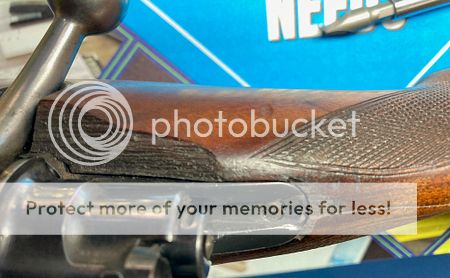

Looking at your first picture - that chunk missing behind the bolt handle. Some references I have, seem to emphasize that Mausers need to transfer recoil from receiver to stock only at the recoil lug up front - no where else - if that recoil shoulder goes mushy or pounded back, (ones with the metal cross bar can happen in the wood around and at ends of the bar) then the whole receiver moves to the rear - typical split straight out the rear, but almost looks like the shoulder on your receiver is really tight to the wood stock - maybe what causes that chunk to crack and then fall off?? Should not be contact - should not be recoil transfer there - Not certain about repair if you do not have that chunk that came off - maybe dead flat cut - glue on similar coloured block, re-carve, re-shape to match your stock? Obviously want to attend to that before doing any refinishing. Not sure what you have going on directly behind the tang - almost looks like wood chips have been removed there, too - all goes to making the recoil shoulder suspect...
I have the skills to replace the chunk missing behind the bolt handle. I agree that a flat with a matching piece of walnut glued in will work. I have to figure out what caused the damage and I suspect that a good bedding job will stop a repeat of the damage to the stock. I hate to upset the patina of the stock with a new finish but that will be the only way with this old timer. I am quite pleased with the accuracy and hope that hand loads and bedding will improve things a bit.
