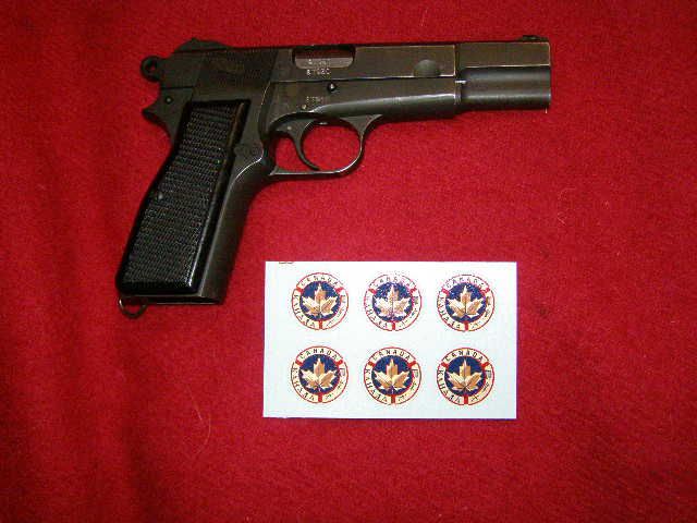

Back a few years I received in a trade, reproduction decals that go on the grip of the Inglis HP.
I was thinking it would be great to have a minty HP and replace the missing decal with a repro.

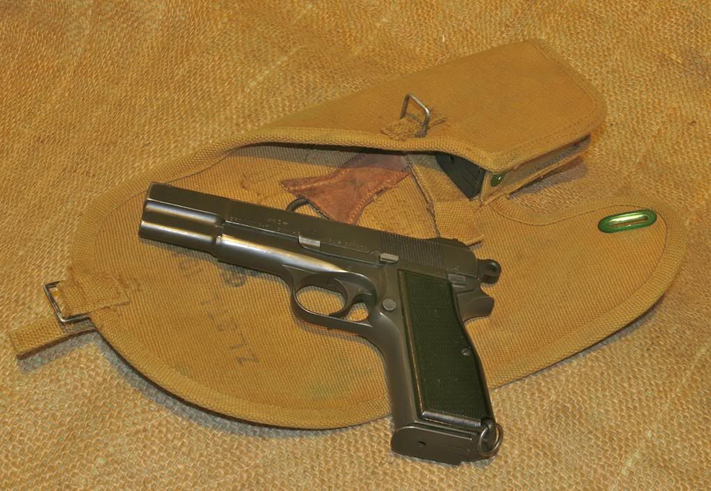

anybody have an original ww2 CF holster or good pic of one ?
First type (Chinese contract specifications) -
Second type -
When the Inglis pistol first made it into the field in Europe (early 1945, possibly very late in 1944) contemporary photos show it being carried in a variety of existing holster patterns. For example (left to right) - standard pattern 1937 revolver holster, flap open; standard P37 revolver holster with spare mag pouch affixed to front; P37 Armoured Corps pattern revolver holster ....
The first type of holster specifically intended for the Inglis wasn'tt too popular, according to Clive Law - too stiff and tight, so the flap was difficult to close over the pistol, so one sees photos of it being used with the flap unfastened or even tucked back behind -
As for the second type of Inglis holster, I can't recall ever seeing a WWII-vintage photograph showing it actually being used in the field .... although I assume it dis see some such service. This photo shows British MajGen A.J. Cassels (Officer Commanding Commonwealth Troops during the Korean War) presenting a medal to a member of the Royal Canadian Regiment -
