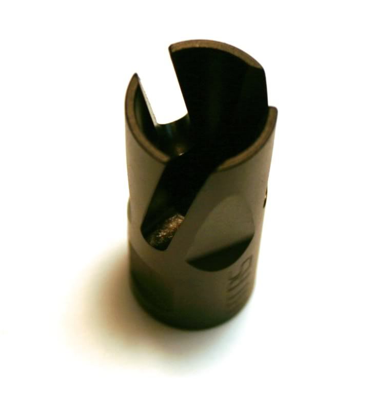

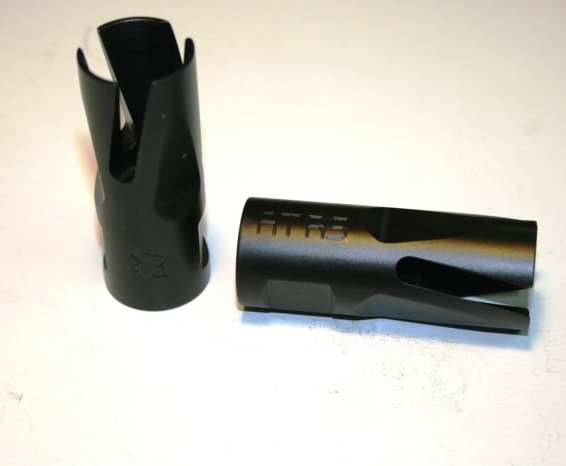

After several months of R&D then significant testing a new flash hider in now available for the AR15 rifles in 223 or 300 Blackout caliber.
These eliminate flash as well as our "Eliminator" but have the added benefits of being much lighter and employ muzzle compensation.
Historically you got either flash elimination or you got muzzle control but not both. We have solved that.
The LFE sells for $125.00 and comes in either 1/2x28 or 5/8x24 threading depending on the caliber.
Detailed instructions come with each unit as well as a dedicated crush washer for installation.
These are made from 4140 chrome moly steel, weigh 87 grams and are 22mm OD to support NATO spec attachments
We will be shooting another video like the we did with our Eliminator flash hider, the results will be extremely similar :D

They DO direct sound down range much more so than a brake does. Any more so than any of the other flash hiders of similar design? Hard to say.
On the 14.5" and under they really excel, over 14.5" like with all flash hiders there is diminishing returns in effectiveness.

The device is not symmetrical and therefore MUST be indexed.
Recoil reduction is nil, it was engineered to help reduce muzzle climb.
Is it as effective as a brake, not at all, but it was not designed to be.
Actual figures on anything , not really. Everyone who has shot with 1 has agreed that there is noticeable but not massive muzzle climb reduction.
Not symmetrical - I take it one of the slots is longer than the others or is there some new feature I can't think of?
