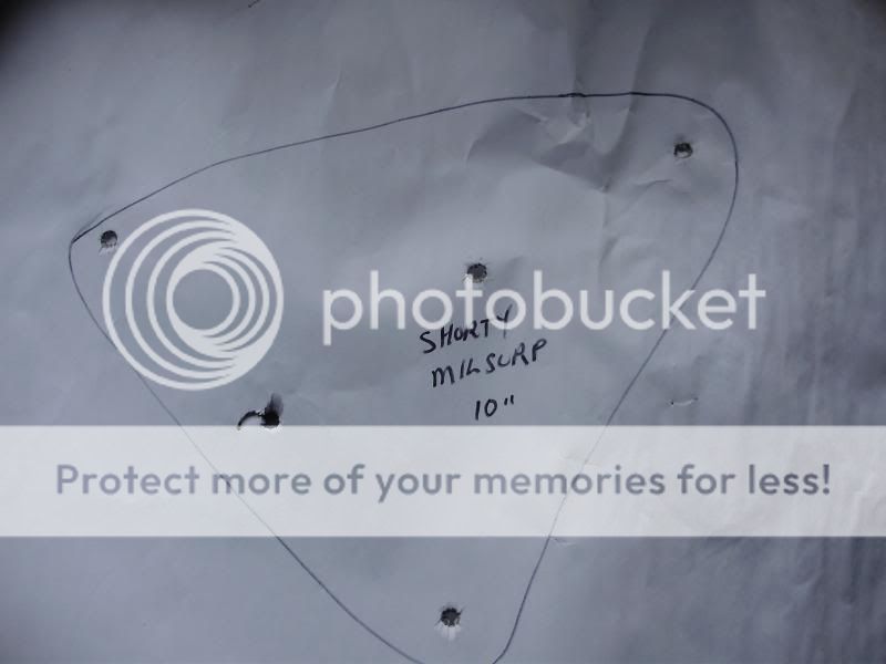

I put up a 10" black square on a sheet of white paper as an aiming mark and target. With the rear sight set to 100, the elevation was perfect, and the wind was very good with milsurp ammo - but the group was huge. 10 inches.

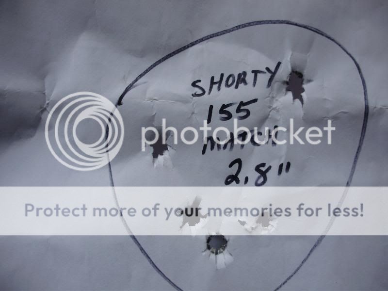

Then I loaded 5 rounds of match ammo loaded with the Sierra 155 MatchKing. 2.8" Much better, and easily the limit of iron sights with my old eyes.
Conclusion: Any time a rifle shoots better with match ammo than with milsurp I conclude it is a good rifle. A bad rifle can't tell the difference. Out of the box the trigger is very good. I will give it a quick bedding job and call it done.
