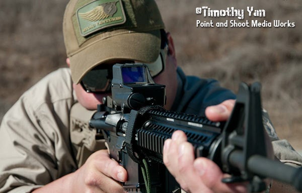

Here's another shot of the Mepro M5 in the states!

why is the guy closing one eye while looking thru a reflex sight?
That guy is looking silly because he's an actor. We can't show the faces of real IDF special forces. :D
The left eye is a glass eye, and it reflects sunlight, thus revealing his position. Squinting it is a tactical move. If he wants to signal friendly aircraft, he opens it wide and blinks rapidly. He has a patch, but it's a third camo pattern, and he felt it would ruin the whole outfit.
Love this answer!
