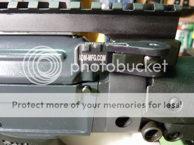

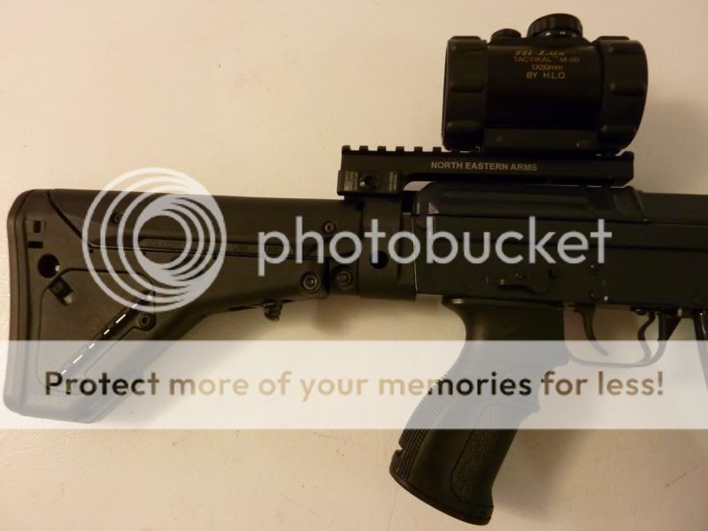

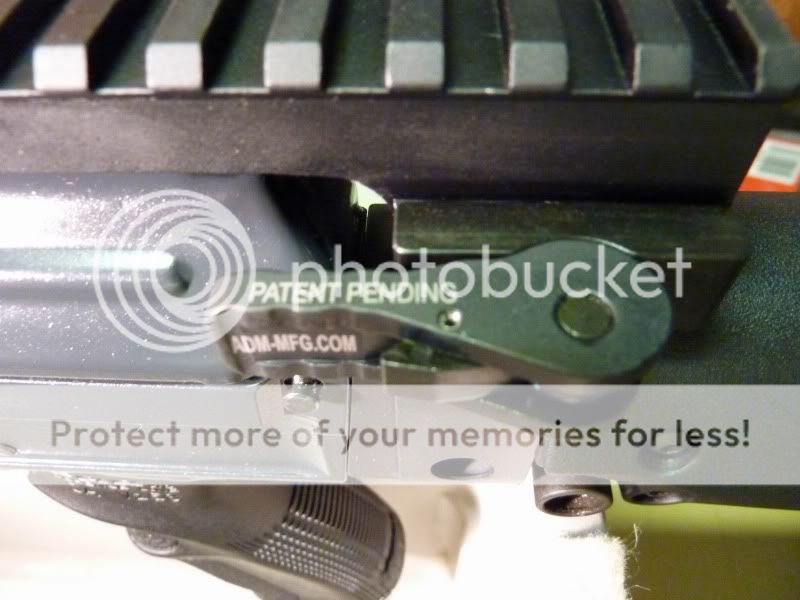

Edit: I had to go way back through my pics to find this one. You can see that the ADM mount sits fairly close to the receiver cover and the lever will overlap the cover when it's locked. It should cover the whole railed section, with a bit of the mount hanging off the back of the adapter.

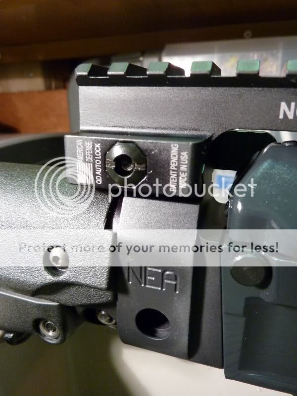

With it unlatched, push in on the lever side. That pushes the hex nut on the other side out from the mount base and you can then adjust the nut to change the tension.
I dug mine out of my junk box and played with it a bit just now. You should be able to get it fitting properly and tight to the mount pretty easily.
The stock adaptor is tight to the receiver? That could wobble too.
