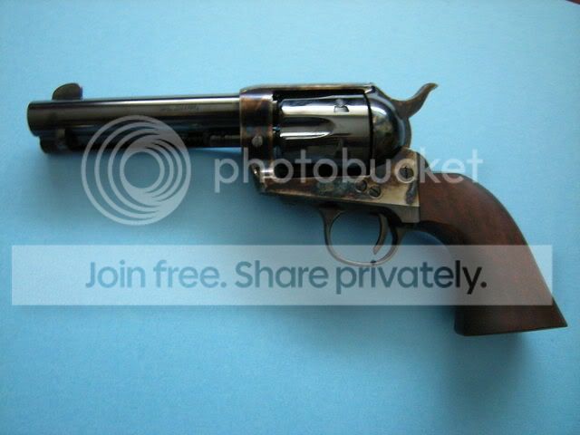

I have a "2nd gen" model but with the blued steel frame, case color receiver and walnut grips. Also, in .357 Mag.
Pietta [top] and real 2nd gen Colt SAA also in .357 Mag for comparison [bottom]:
IMHO, Pietta makes a very pretty SAA.
