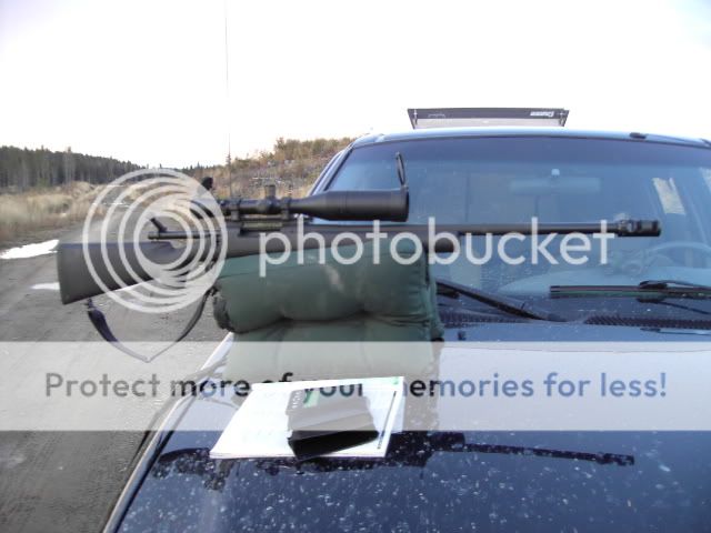

New Remington 700P .338 Lapua. New photos on page 5 now.
IMO Rem 700 action is not strong enough for 338 LM cartridge, two tiny front locking lugs are barely adequate to hold that amount of back trust. That brazed bolt handle can't be counted on as the backup lug in time of need. The Ruger magnum, Weatherby Mk5, Brno602 or S/L mag would be much preferable actions from the safety point of view and peace of mind. My 2c.

yeah pretty sure those are burris XTR rings, in which case they are backwards and must be turned around so the 1/2" nut is on the LEFT side of the rifle.
reason for this will be evident when you dismount them. the main mounting bolt has only one squarely machined face which needs to push against your rail on the front, as that is the direction recoil will push it in. right now, the round side of the bolt is forward, and it chewing against your rail and moving slowly forward.

I've heard this often, but I still wonder what it's based on. Has there ever been a documented case of Remington actions failing?

Very nice rig, thank's for the pic, now, i have found my next scope for my build, i'll give Jerry a message
