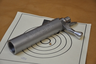

"After a hiatus of nearly twenty years, Shilen Rifles, Inc. is proud to announce their return to the rifle manufacturing market. After several years of painstaking research and development, Shilen is now producing complete rifles that will fill the need of any accuracy minded shooter.
Each rifle's foundation is a CNC precision crafted stainless steel action. Actions are available in either a DGR (D@#% Good Repeater) or a DGV (D@#% Good Varminter) configuration. Both are immediately available for right and left-hand shooters. Both actions have a 1.350" diameter and feature 8-40 scope base mounting screw holes. The bolts are spiral fluted, have a floating bolt head, an interchangeable bolt handle knob and are available in most common bolt faces. Each will be offered with a .300" pinned recoil lug for added stability. These actions feature a footprint similar to the Remington Model 700 and will accept many aftermarket components."

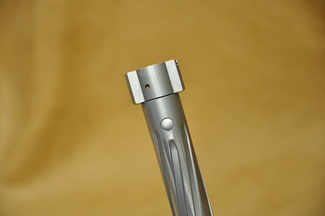

Looks like Shilen is blending the best of two action philosophies - the floating bolt head and barrel nut of the Savage to headspace and control the lock up of the action. Also, allows all the options common to the Savage for swapping bolt heads to change chamberings.
The exterior footprint, bottom metal parts and trigger options of the Rem 700.
A blend of the best of both worlds. Very interesting indeed.

I chuckled at the hammer in the picture. Whoever took that picture should have known better.
Price and reputation will decide for me.
That is a precision Stanley hammer don't you know... perfect for bedding jobs, touching up the crown a little, adjusting trigger pull, lining up rings...
Me too...Was going to rib Jerry about the sledgehammer....Is that what you use to adjust those new fancy Sightrons? :D

I have big reservations about that action. Whatever good that blend gives us they regressed in gas handling capabilities. There is no front end bushing (donut) on the bolt like Remington's to expand and seal the chamber when cartridge brass head gives up and no second baffle behind locking lugs like Savage's to seal off the bolt race ways also there are no holes made in front of the receiver ring for the gases to escape. The concept is very interesting but those issues must be addresed first. As it is, this is not a safe action and I will pass, thank you.
Great observation.
I will pass on the thought to Shilen and see what they have to say.
Maybe preproduction pic but yes, no vent holes visible.
Would assume the bolt head is recessed like the Savage and Rem. Also the barrel may have a recessed chamber like the Rem so that would duplicate the Rem 3 ring steel concept.
The rear of the bolt would be similar to a Rem which has served well for decades.
The only obvious missing thing is the side vent holes.
