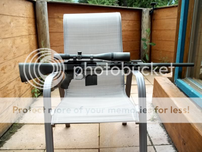

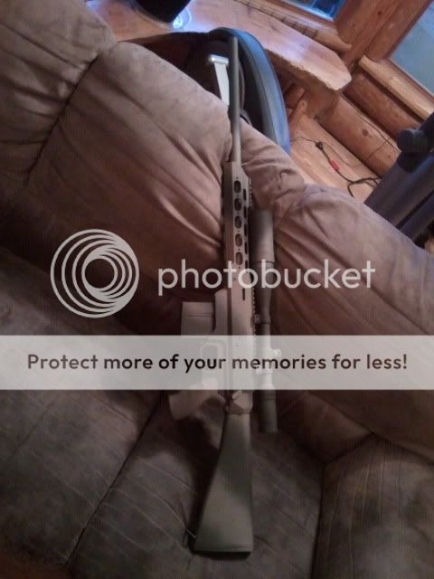

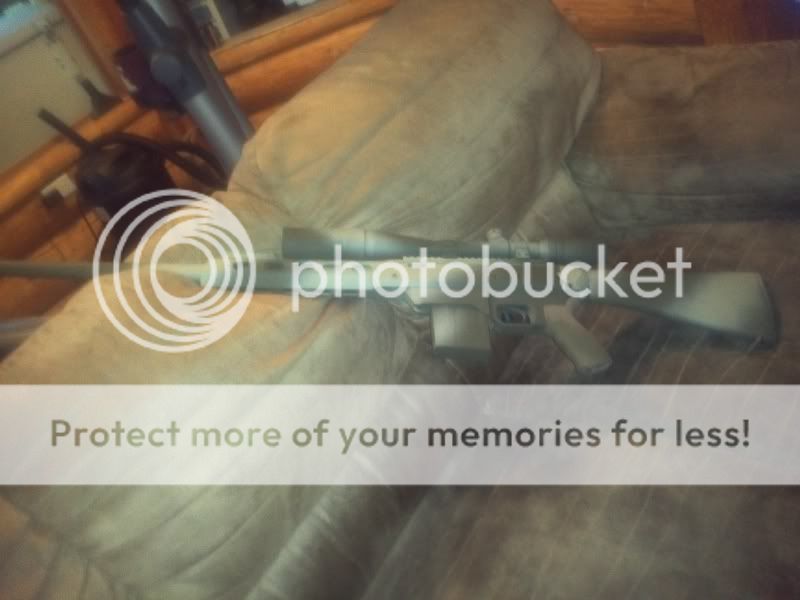

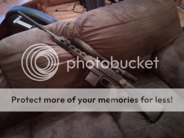

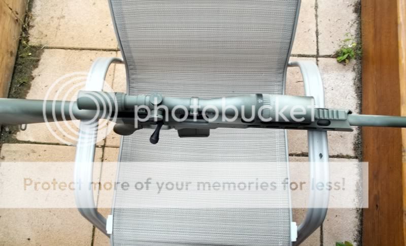

So picked up the The New MDT chassis for my F class 308 and did some painting then baked it a little ,,,

I used Krylon flat metal Paint I took the rifle apart Scotch brited the whole rifle then cleaned it off with Brake Clean. Pre heated it with a heat gun placed it standing on a lazy Susan with a chop stick in the end of the barrel to Rotate it I primered it first then heat gun , then a full coat of drab heating and drying 15 mins between the 8 coats I put on then I did the Coyote and heat gun dried 15 mins and that was 8 coats. I then placed it in the oven That I had preheated to 350 and had shut it off and when it was around 100 degree's I placed the metal parts NO SCOPE in till it had reached room temp , then a mat clear over the whole rifle assembled . According to Krylon after 7 days its scratch and chip resistant. Cost $35.00 and time
It looks good, but it's hard to fully appreciate your efforts with the rifle sitting on the couch.
Color contrast!!! Maybe take the gun outside for some more pics.
