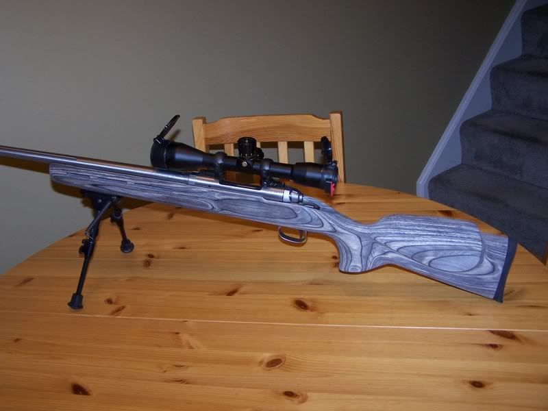

Hi - Well, finally got my Boyd's Target Varminter after 10 months - now it's bedded, and going to do the finishing work next.
Savage 12FVSS in .223
Rifle Basix Sav1 trigger
Burris Rings
Bushnell 3200 10X40
Boyd's Pepper Laminate Target Varminter
This started life as a stock Savage, bought from the ORA.
Next - hmmm, new barrel in a 1 in 7 twist, or new glass. Depends on what Santa brings.

Well, just finished coat# 4 of Tru Oil, was bedded last week, should have a new set of photo's up tomorrow - sure is looking nice though! smooth finish, and I really like the look.

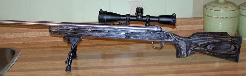

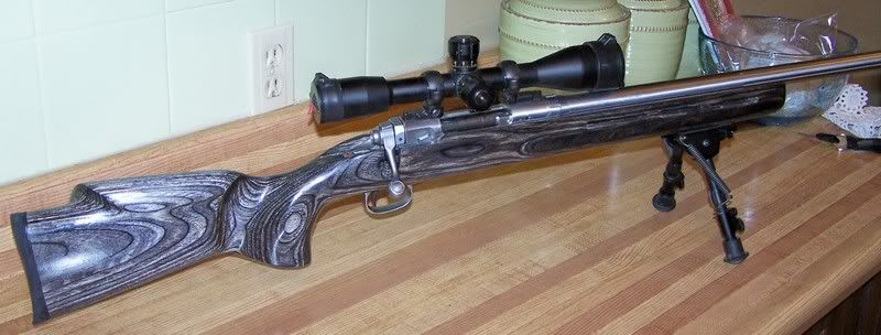

Updated Nov 7 - Nearly Done (image heavy)
Well, here is the progress - sanded with 120 grit, 150 grit, 220 grit, wet to "whisker the wood" and sanded then with 400 grit.
5 coats of Birchwood Casey Tru Oil, rubbed with 0000 steel wool between each coat.
I think I want to rub it with the steel wool one more time, and then use the stock sheen in it - I like it shiny, but find I was not as careful as I should have been on last coat of oil, trying to cover a couple of spots in the crevasses etc.
Let the truoil harden for a few weeks to a month. Then go over with the fine steel wool and a very light oil coat rubbed in. I found that really got the shine out. Much better then using the stock sheen/wax.
After using the stock, the gloss would fade a smidge. Rubbed with a soft towel and reoil. Twice a year maintenance and the appearance is great.
FYI.
Jerry

Hi Redlaker1 - The fit was pretty good, when it was bedded it needed a bit of wood removal from around the recoil lug to get it to drop a bit, and a bit from the barrel channel to ensure the barrel was free floated. Glass bedded now.
It's fairly heavy, have not weighed it, but definitely more than with the "stock" stock on the 12FVSS. Mine is an older model, pre-accutrigger, so not sure if they've changed since then. Even with the old stock and handloads, it ran very well.
Only pain was the 10 month wait - and now looks like Boyd's is not making that model anymore. I've seen a lot of guys are using Bell and Carlson, also might want to look at Richard's Microfit, I know someone who used them on and really liked it.
