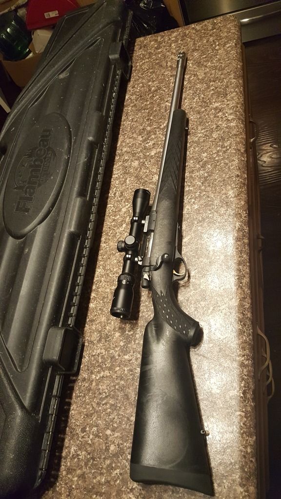

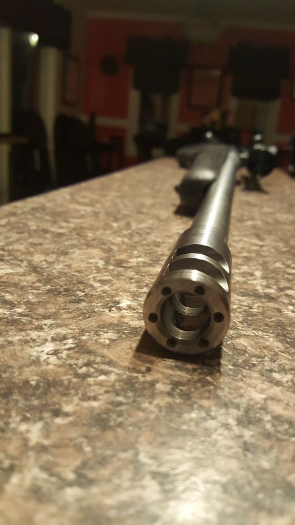

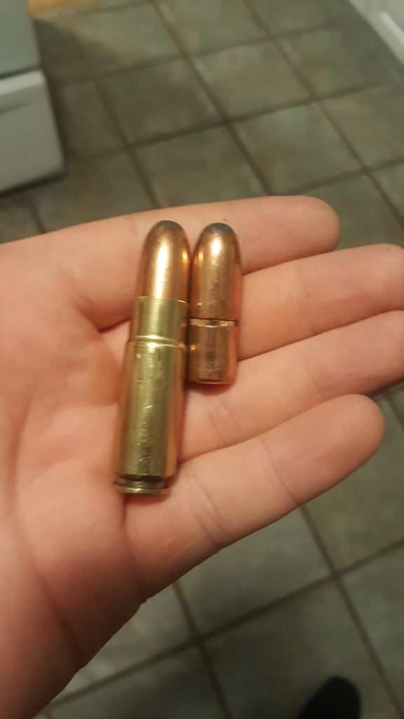

Just picked up my new toy from the gunsmith, a rem 600 mohawk with a stainless 18.5" 458 socom barrel and custom break. Haven't had a chance to shoot it much but it may be my hunting rifle next year. Makes a great bush gun and came in pretty light actually. P.s. i didn't defile a mint rem 600, it was heavily modified when i got it. Updated on page 2 now has detachable mags

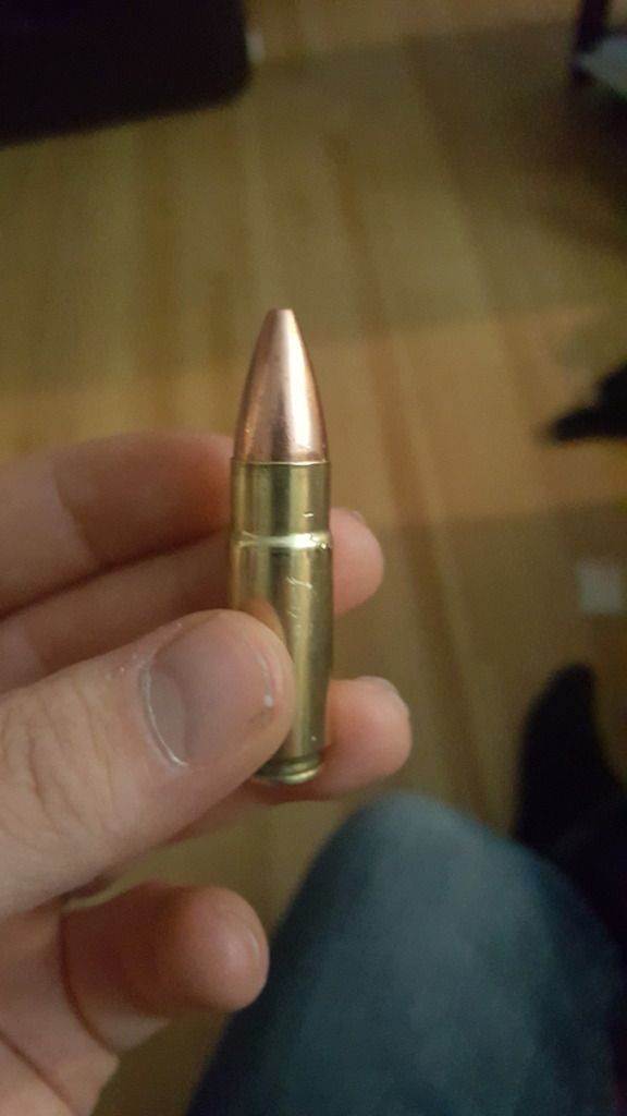

i had an ar in 458 already so i had components to reload. 450 bushmaster comes in factory bolt action rifles and factory ammo is available. 458 socom is reload only in canada from what ive seen. Its really up to the shooter. I enjoy 458 so i stuck with it

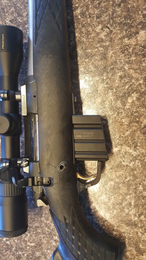

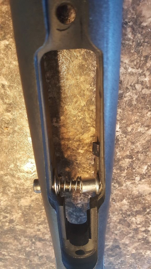

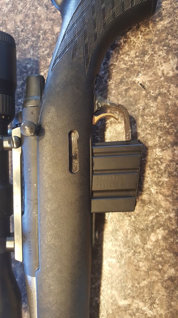

Well after lots of grinding and epoxy and a couple different designs, i now have detachable magazines. I was able to use an ar style magazine catch and inlet it into the stock and with some springs and washers its in there. I also modified a metal trigger guard to add some stability on the back of the mag. Its a little rough around the edges for now but some sanding and touch up it will be all done. Mags fit tight and straight. Very happy with how it turned out.
So fricking cool, nice work!
The trigger guard is a bit of a hack job but you can build something in the future once you've used it for a bit.

Yes the trigger guard is far from perfect but it works for now, was a quick addition. The stock one was very small after the mag was put in. This was the prototype to see if it works at all and now i know it does ill get another floorplate and try again. Theres a few mistakes that i was able to fix with epoxy but ill make a nice clean one soon.
