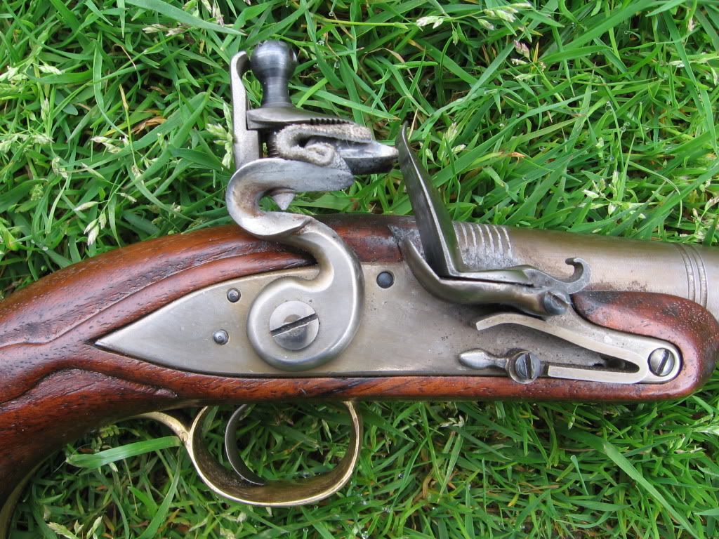

I would hope to get at least 20 shots from a decent lock and flint before having to knap it back to sharpness. Usually a flint can be knapped about 3 times before becoming too short to function properly. Be sure to wipe the face of the frizzen clean with your thumb each time you prime the pan and keep oil away from the frizzen face. Experiment with the frizzen/flint geometry: sometimes a flint will spark better with the bevel down rather than up. It is the scraping action of flint on steel, rather than direct impact, that creates the sparks so strive for the longest scrape track down the face of the frizzen. As for a reliable supply, several M/L supply shops have them in the various sizes so check websites or attend a B/P shoot... The correct size flint will be as wide as your frizzen and long enough that when set at half-####, the sharp edge is approximately 1/8" from the frizzen face with the frizzen closed down on the pan. Good luck and have fun.
Here is a picture of the lock in the half cocked position,the flint is about 1/8 inch from the frizzen. These are English flints which are hand knapped,they appear to be the right size for this lock.

I have knapped cut flints with my short starter as a mallet and a 3/16 brass rod but I still consider them to be a second best alternative to english flints. What I never seem to get around to doing is to make a couple of spare top jaws for my lock and put a lump or pedestal at the back edge so that the jaw will angle down on flints with a high ridge in the center. The ledge on the vertical post on the hammer governs how high of a flint the top jaw will clamp level on and if it is too low, the top jaw angles up and pops the flint out. By putting a bump on the back bottom of the top jaw you are in effect raising the ledge and able to use higher or thicker flints
