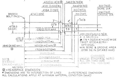

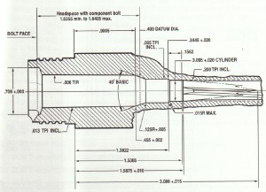

New to M14 Norc thing. Anyone have a pic of what the Chamber should look like?

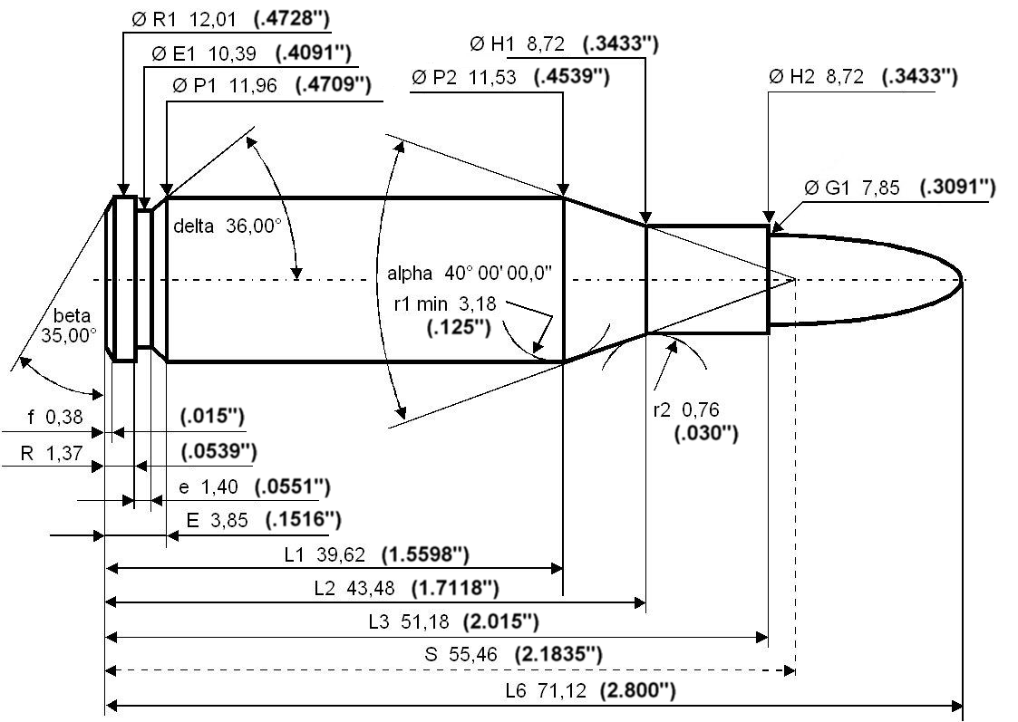

Anyone have a pic of what the Chamber should look like? Also with a snap cap in chamber and magazine out I can see the back end of the round. Is this normal?
"Exploded view"
Chamber Dimensions (SAMI)
You can see the rim clearly when the cartridge is chambered
Go to a drawing of a 308 cartridge, such as on wikipedia. The 0.1516 of the tail end is unsupported. That area is where the extractor snaps over. The back end of a cartridge like that is very thick walled. No issues.
