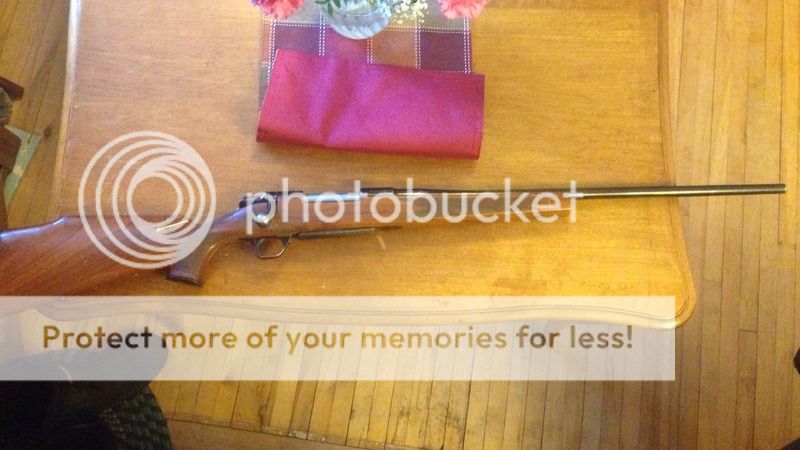

I took a look at a repair done to a BBR in .30/06 to a friend of my Dad's a while ago and thought it seemed like a well made (if not boring because it's an /06 ;)) rifle. A couple weeks ago I asked for his advice on a Citori and he asked if I wanted the rifle as he'd replaced it with a Tikka. I picked it up today and here it is.

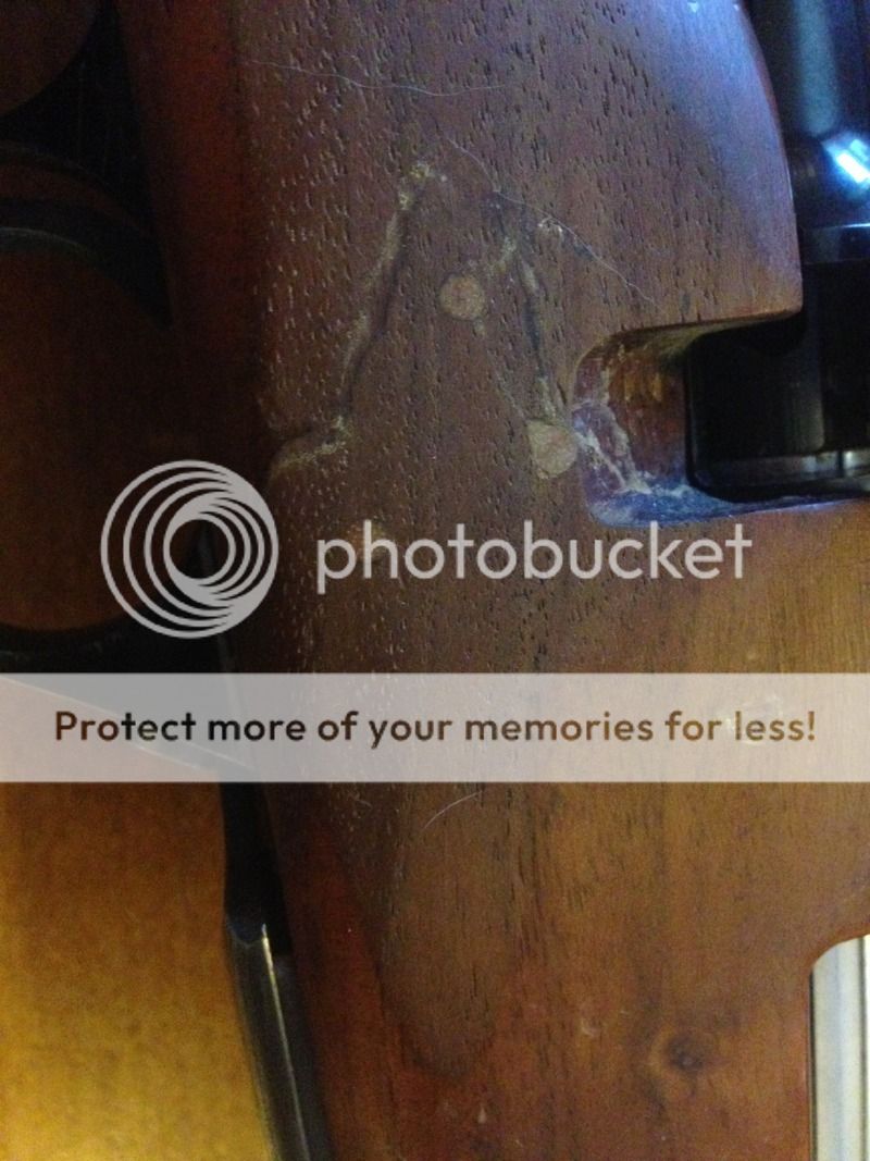

Here's the repair
It was done by a local paddle maker, so I'm assuming it's done well. According the previous owner, this stock cracked, then the replacement "monstrosity" synthetic stock cracked so he had this one repaired. However, he doesn't like the cracked stock, so he didn't use it.

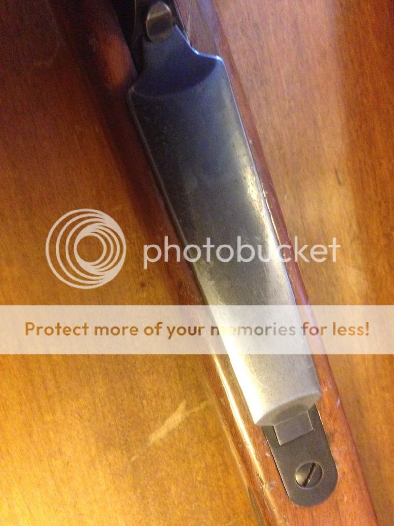

There's some honest bluing wear

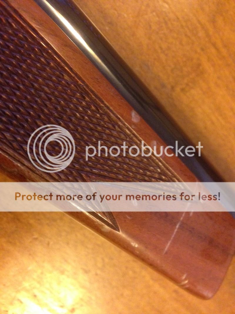

And the finish is "cracking" all over

My plan is refinish the stock, mount a scope and then hunt it this fall and hopefully shoot a deer with it. Any suggestions for bases and rings? Any thoughts on the BBR in general?

The BBR was made from '78 to '84. The later rifles (mine is a 1984, last year of production) had a rosewood cap on the fore end, I think they only did that in '83 & '84. I suspect the OP's is likely a 1979 to 1981 model, judging by the stock.

I've never owned one, but they seem to be predisposed to broken stocks. Yes/No/Maybe?
The broken stock situation was primarily on the larger and/or magnum calibers. Generally, the .270's, the 30.06's, etc. were not as affected. As one poster noted, although the stocks were/are walnut, they didn't seem to be a "hard" wood, and the stress of firing the larger/magnum rounds seemed to get focused on the pistol grip area. But the 30 cals and lower non-Magnums weren't as prone to stock issues.
