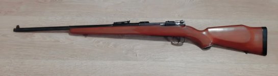

New to me Husqvarna 6.5x55
Husqvarna primarily made M38 rifles. They did make a smaller number of M96 (long) rifles for range use.
Yes the m38 sight matches mine. Thanks for the quick response everyone.

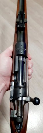

Your bolt handle has not been altered. You are going to need very high rings if the handle and safety are going to clear the scope. See-through rings might be an option.

Tiriaq called it right, M38. Your rifle has be drilled and tapped, so getting the bolt altered for a lower scope would be well worth it IMHO.
Best option, would be to get the arm bent down and a machined knop added to the tip of the handle.

If I do put a scope on it I assume any competent gunsmith can do the modification required.
As well as playing with the bolt handle, if you want to install a scope, consider how you will deal with the safety - most Mausers were iron sighted - so the "over the top" safety was not an issue - but will not work if you mount a scope that you are able to see through. I have had a number of rifles here where the "flag" was sawed off to be short - it would then swing under the scope eye bell, but was much too short to be useful. Other options include the "up/down" scope friendly levers made by Parker Hale and FN (left side) or Dayton Triaster (right side) but those give up the third position of the three position Mauser safety. There is also Gentry or Dakota 3 position horizontal swing safeties, but probably pretty serious bucks to get those purchased and installed these days. There used to be a multitude of trigger blocking safeties that came on trigger units - they usually required some stock inletting to work well.
Potashminer is giving you some good options, however, they do make rings for such projects which would be acceptable and you don't have to touch anything or add to the cost.
If that were my rifle, I would opt for the "see through" rings, which allow you to use the open sights as well. Decent quality scopes seldom have issues but it's nice to know that if you're on a hunt and drop the rifle, or damage the scope, you can still use the iron sights.
If you do decide to go with the "see through" mount option, get a leather cheek pad for the butt so you have a spot to weld your jaw to while using a high mount scope. They can be had online for under $30 delivered. They also make some very nice Cordura cheek rests, with shell holders for the same price.
