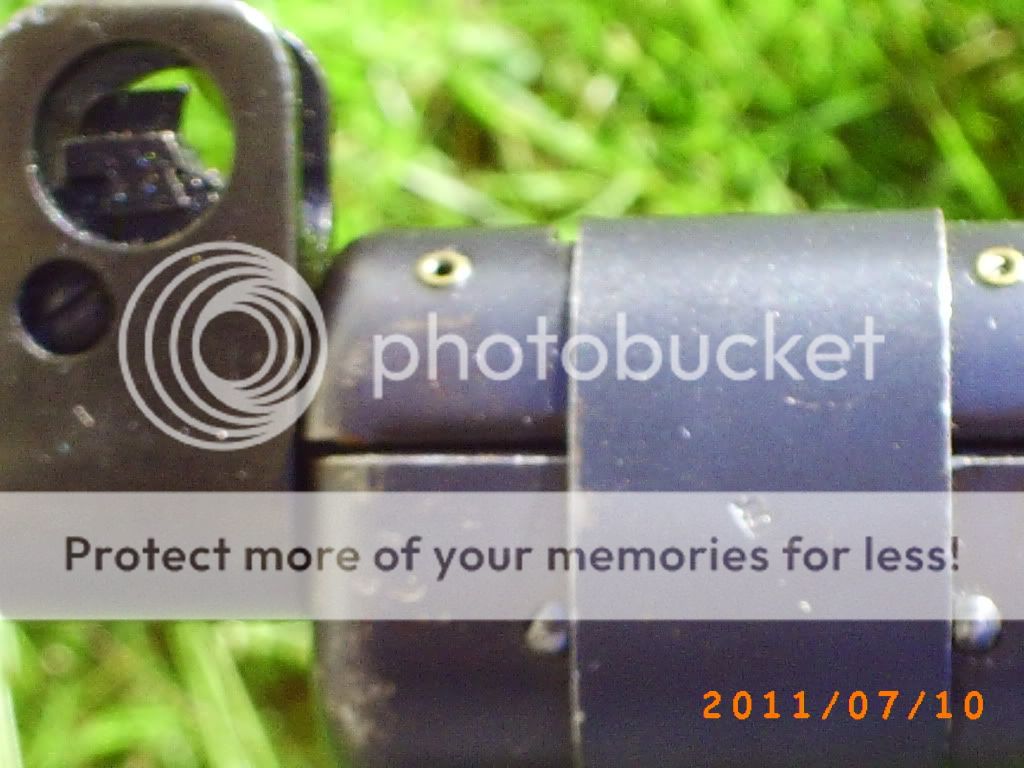

Just took some pics, so here they are!

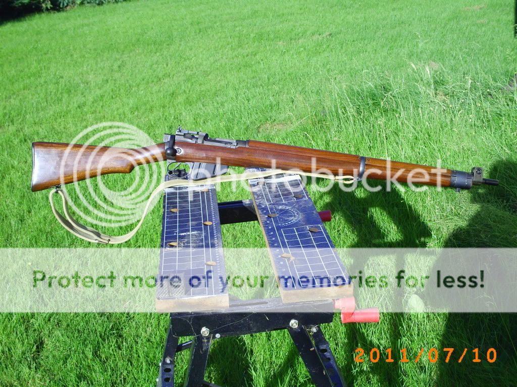

First, a couple full body shots of the old girl.

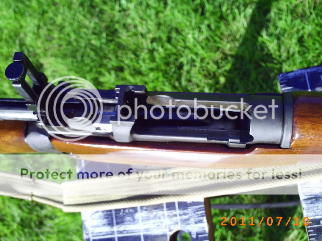

Action:

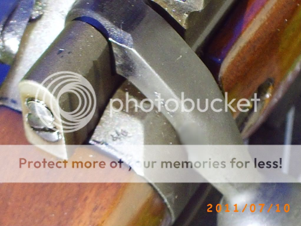

Cocking Piece (with savage stamp?)

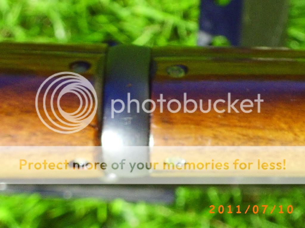

Front band with LB stamp?
rear band with LB stamp?

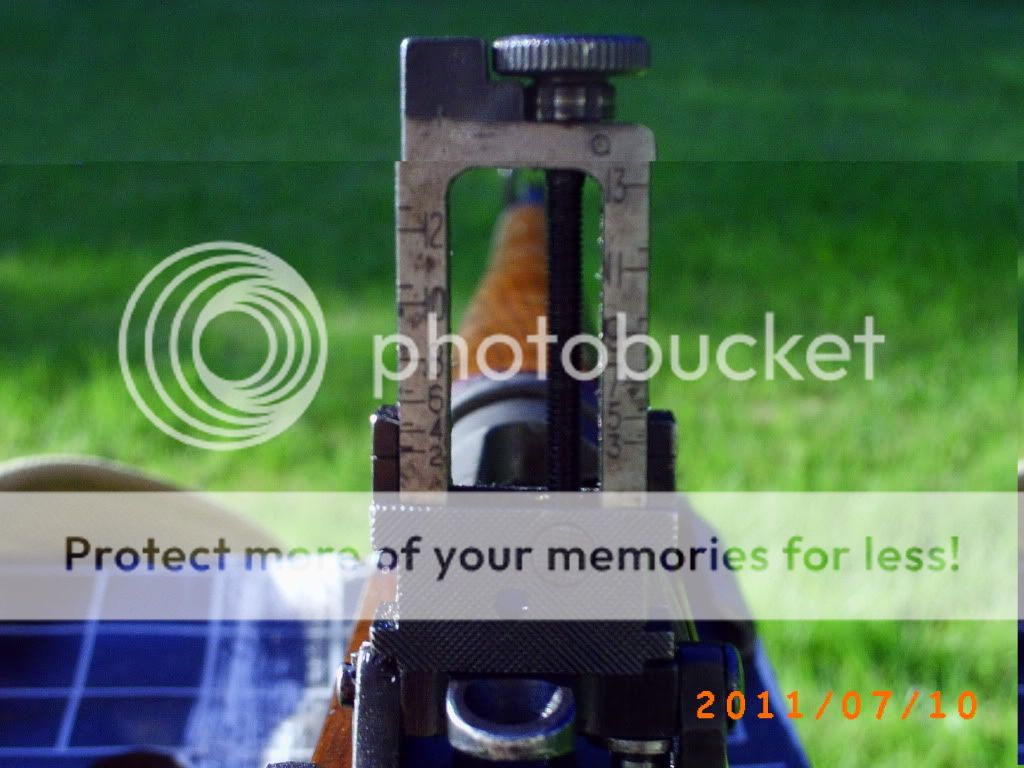

Rear sight

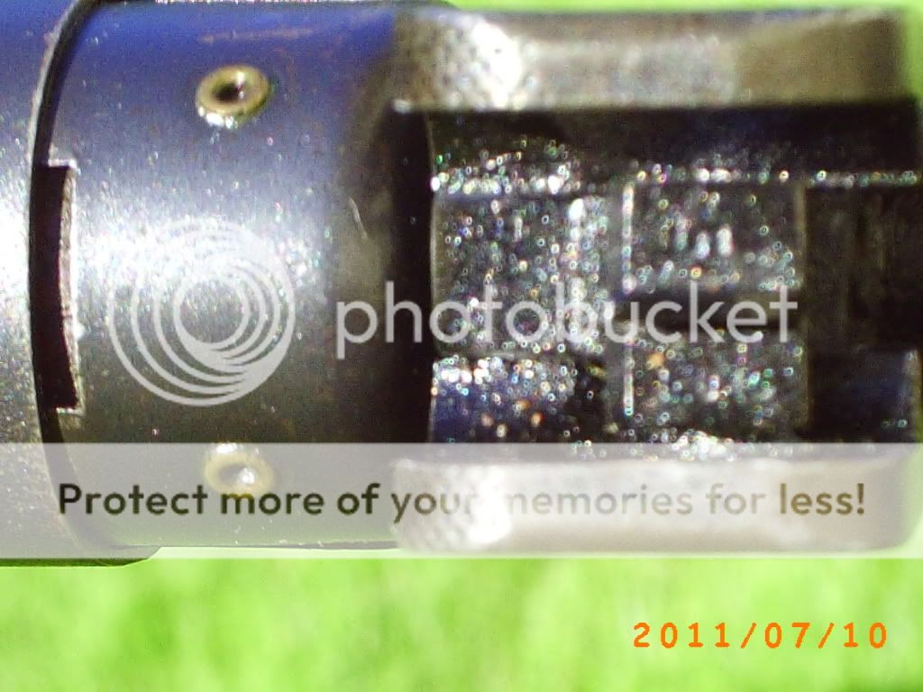

rear of reciever with d/p stamp and broad arrow stamp?
bah...the pics of the stamps didn't turn out very well :(

Your "B" stamps are actually "LB" stamps; it's just that the two letters are over top of each other: Long Branch (Canadian).
Your funny "5" stamps (cocking-piece, etc.) are acutally squared-"S" stamps: Savage.
When the Armourers worked these critters over, they used whatever parts were handy. There was no effort, especially in the British Army, to keep Fazakerley parts on Faz rifles, Maltby on Maltby, LB on LB and so forth. If the part fit, they used it.
Rifle likely saw service in Britain; it has the safety they liked. They didn't like our model of safety!
