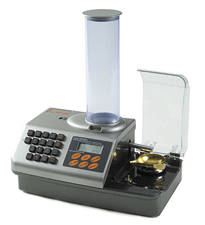

GET A GOOD DIGITAL SCALE FOR LOADING!!!!!
It is absolutley, horribly, mind numbingly slow to have to wait for the balance scales to even out at the right weight. Even the cheaper digital scales can be a pain in the buttocks.
I finally upgraded to a Lyman 1200 DPS3, and it was the second best investment in my loading setup, next to my press.
You don't have to fill it manually if you don't want to, and you can also auto repeat the charge for loading many rounds. A smart design.
