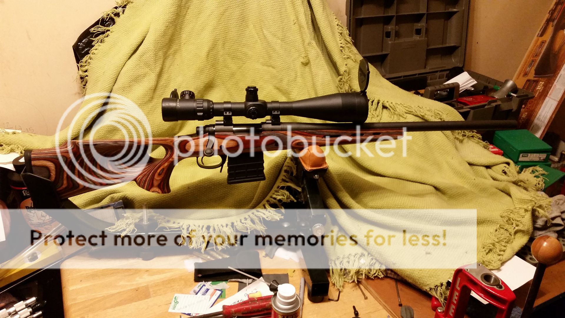

Well it's 6 months until my Birthday but my new toy will have to count as my present.
Rem 700 SPS (Varmint?) In 223 Remington. Barrel cut to 20" Boyd's thumbhole stock, Sightmark 10-40x Scope with illuminated Mil-Dot, PRW rings, PTG bottom Metal, MDT mags, and a Smith tuned trigger
My question is with a 1in12 twist what bullet do you recommend? Punching paper and coyotes, Ridgedale only has 200yds which will have to do for a while. I know stability mostly relies on bullet length and velocity. There are long 55gr bullets and short 62's. Berger lists up to 64gr flat base with a 1in12 recommended twist. I hope to start stretching out the distance to 400yds by fall. Favorite bullets?
