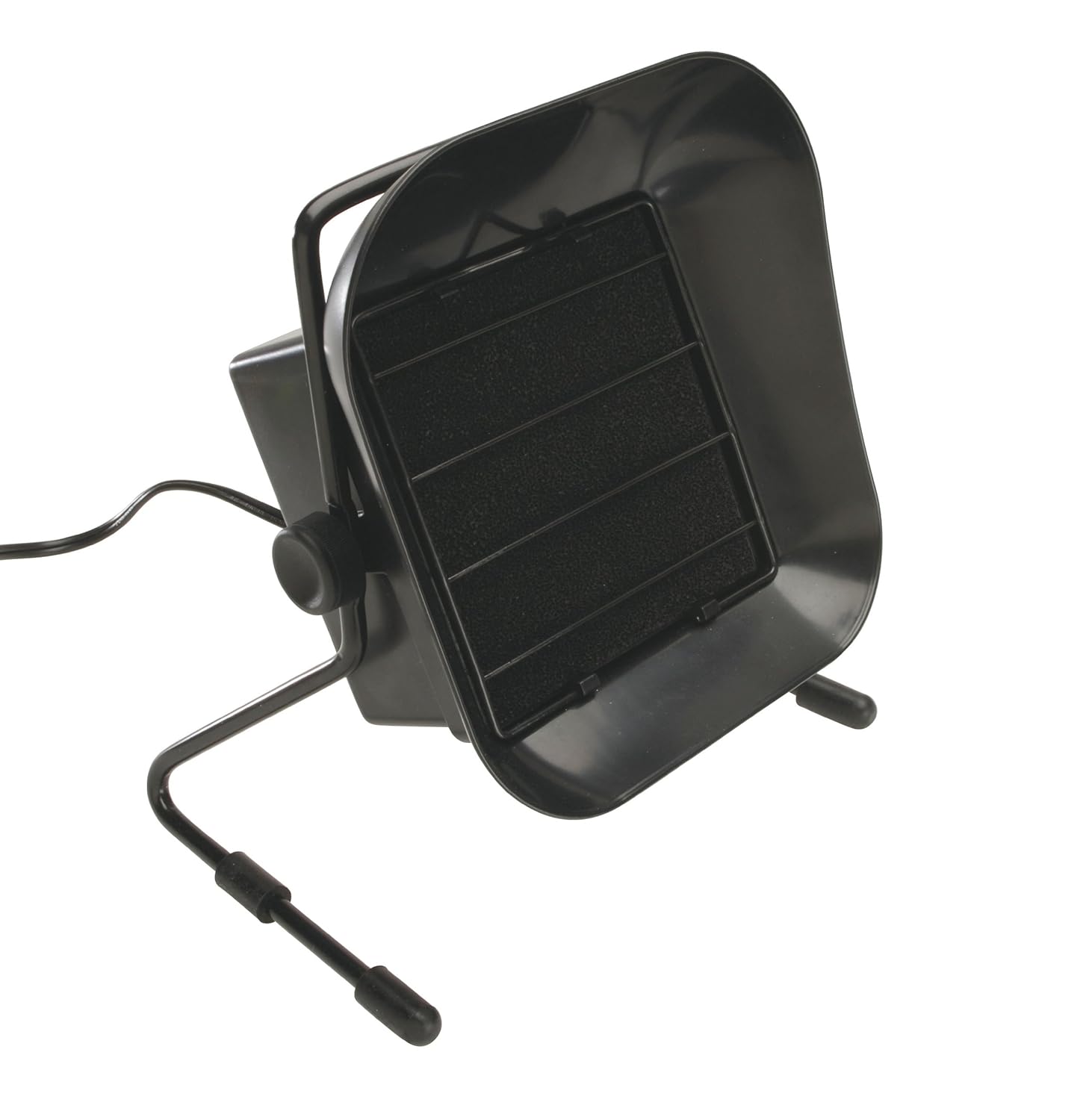

I use a desktop solder fume remover with a charcoal filter pointing out to an open window. I can visually confirm that the smoke/fumes are blowing directly into the extractors hood

What is a "desktop solder fume remover" and where can you get these?

https://www.amazon.com/Weller-WSA350-Bench-Smoke-Absorber/dp/B000EM74SK
Don't think a "desktop solder fume remover" is going to cut it in my case. Would have helped with some of the other stunts I've pulled off in my shop/work space though.
