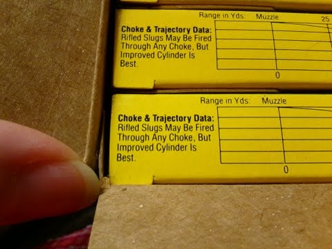

Foster slugs/rifled slugs will be fine in a modified choke they are meant to swage down. Remington rifled slugs even say safe for full chokes. I would stay away from Brenneke slugs though they are harder then most slugs.

Nearly all slugs will squeeze through any choke up to lets say "Full". And I say "nearly all" because there a few exceptions. But they are not very common.
In short, you can shoot slugs, buckshot and bird shot with any of those chokes that you have.

You can safely shoot rifled slugs out of chokes up to a full choke, shot patterns and slug accuracy will change with different choke constriction and different brands of ammo will change things as well. I generally find mod gives me the best patterns and slug accuracy.
