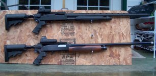

I solved me gun fit issues yrs ago by going to the Al Ljutic Spacegun style that caught me eye back in the day. His layout, though a tad quirky
to some folks spurred a big desire in me to have an 870 pump set up like that led me to the Mesa Tactical, high tube recoil stocks that I found
on the GB Tactical site.
I'd been shooting trap for some yrs prior to that using red dot sights on factory stocked guns with decent results at meat shoots but the
AR layout with its straight line stock to bore relation plus the Enidine recoil shock in place of the AR buffer tube really worked great for
me and made my 870 super easy to run long round shoots with comfort & confidence. No cheek slap & recoil reduced to 20 ga target
load levels. Fitted this system to a Win 1200 & Mossberg 835 as well. The Mossy was me favorite for Annie Oakley shoots and shoot-offs
when we'd call "To the beach!" shots. Closest break to the dirt be the game.
Me 870
Me Mossy 835 & Win 1200 units.
