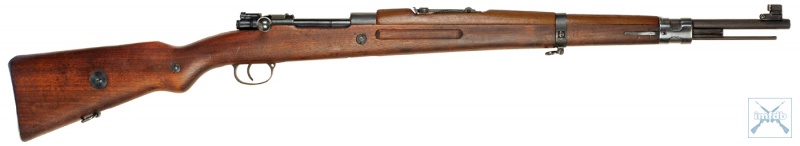

I have been looking for a K98k.
Through all the research and browsing, I notice a significant visual difference between K98k and all other similar rifles: the upper handguard. German military K98k rifles all seem to have a shorter handguard which ends right before the rear sight, and the chamber section of the barrel behind the rear sight is exposed.
On the other hand, all other manufacturers' (Yugo, Czech, Swedish) and even those made by the Germans for other countries (Spain, Argentine, Brazil) all have an extended upper handguard that goes all the way to the ring behind the chamber.
Could anybody tell me why all these other "Mauser type" rifles are made different here from the very Mauser K98k? Is there a reason why that part of barrel is exposed on the K98k? Or is there a reason why it is covered in all other models?
Any replies will be much appreciated.

Most Mausers have a hand guard that starts at the middle barrel band and goes back to the receiver ring.
For some reason the Czech VZ 24s and some of the Yugoslavian rifles have hand guards that start from the front barrel and goes back to the receiver ring.
The K98s manufactured for the Germans over the years only have the short hand guard as illustrated in your first picture. The K98 short hand guard carried over from the Gew 98s of WWI.
