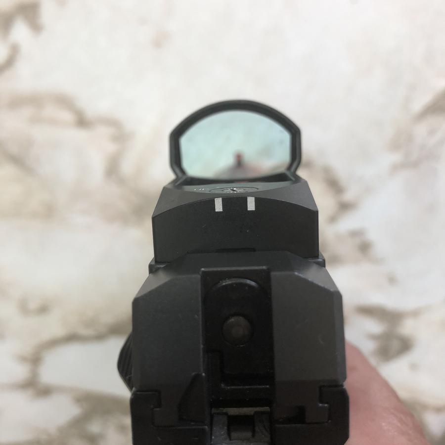

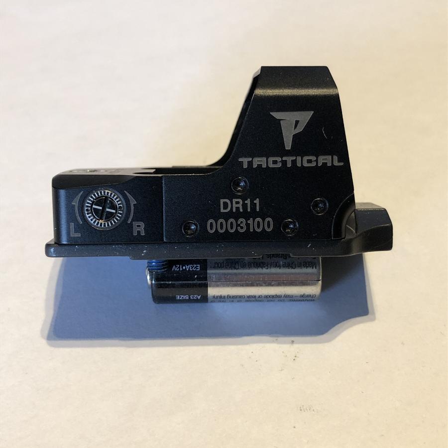

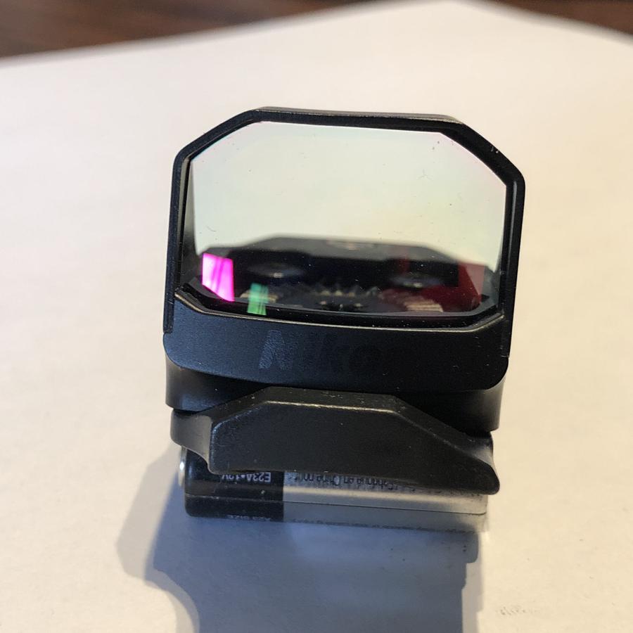

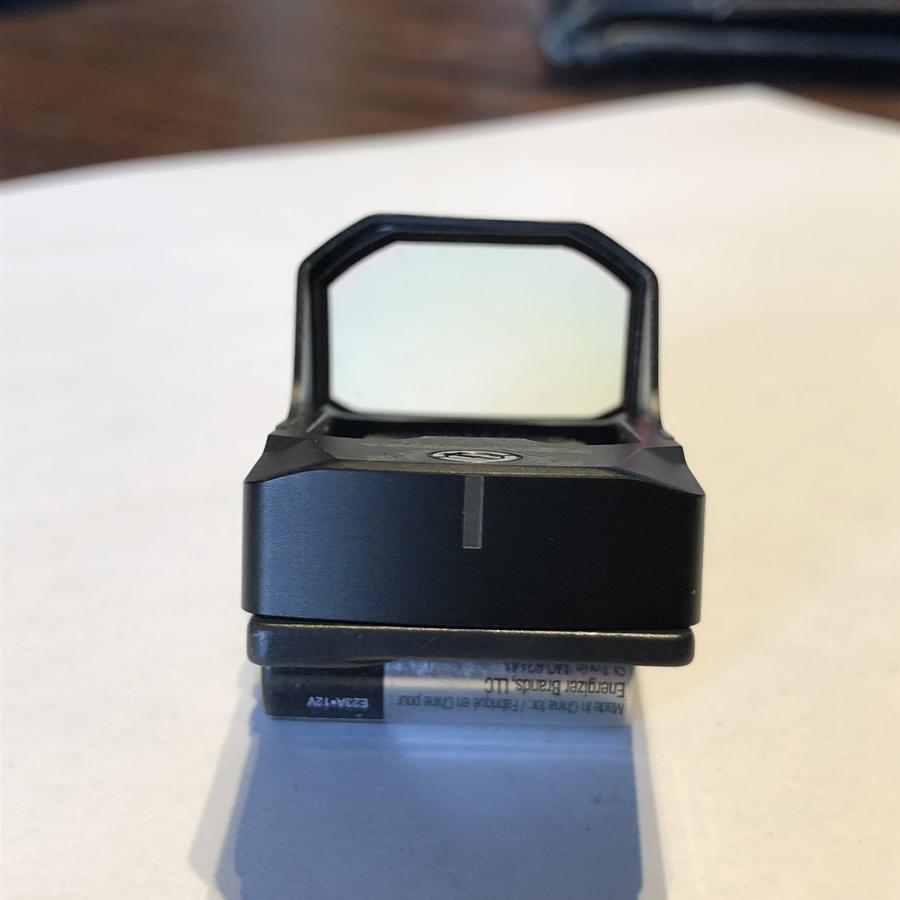

One of the biggest issues of all these new micro optics is mounting them on a pistol. Rifles are not an issue, if you have a Picatinny rail. Short of custom milling your slide there is not usually an option due to their proprietary mounting screw locations.
So we decided to experiment with a Nikon Spur for IPSC Production Optics on a CZ Shadow 2 OR, and from initial evaluations, we think we succeeded by re-purposing a Shadow 2 OR plate.
The overall optical footprint is larger than most, and due to the frame being so thin, the shooter's view should be minimally obstructed.
Looking forward to test firing, range report to follow.

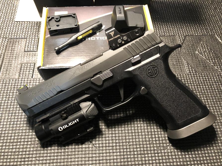

hi I have a Nikon Spur and I would like to fit on my Cz shadow 2 OR like you showed here SO have you done testing ? and what price it would sell?
Here a pic of my X5 project :
The Romeo 1 from sig has the same location holes as the Nikon but the Nikon was longer so I had to remove some material of the front of the nikon to sit perfectly took me 10 min
