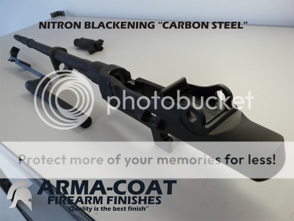

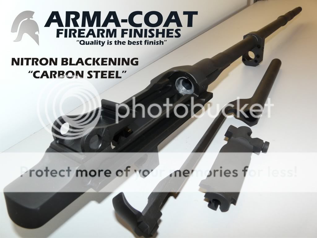

Murdoc, how does the Nitron finish compare to Arma-coat in terms of look and durability?
We can make Nitron in a Gloss, semi-gloss and a matte.Matte is what you see in the pictures I first posted. Arma-Coat would be your best bet if corrosion is a major concern. Look wise they are the same but the nice thing with the Arma-Coat is you have a variety of colors to choose from.
Nitron is an extremely thin finish which works great on extremely tight guns. The only limitation on Nitron is the color as it only comes out black.

When you say (disassembled is faster turn around time and cheaper) does that mean barrel off in the case of the M14 ? or do you do it with the barrel on the reciever ?
The receiver stays on the barrel. By complete disassembly I mean everything that can be taken out that has roll pins,springs,sights and the like,so when we blast the media does not bind up any areas where there are moving parts.
