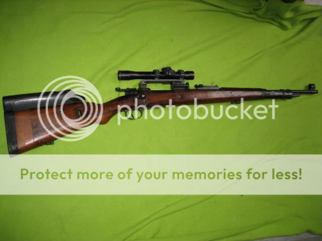

Some of you may have seen when I got this Israeli Mauser. Very not matching, very much a shooter and in no way a collector.
People asked what the hell this was on the barrel...
Anyway, got it put together reasonably correct but with the timney it came with and a S&K scope mount. Old weaver scope that sat high.
Shot damn good with my varget 155gr loads. That's 5 at 100 yards.
But the cheek weld was almost non existent. Got a free sporter stock from EE and did this.
Cut the piece I wanted to use.
Took out the bulk of it with a 3/4 bit.
Lined er up and drilled some holes. 3/8 at the top to allow for filling with dowels.
Put it all together, nice cheek weld now. And appropriate looking. I'm sure you guys can do better with proper tools and a warm garage. Mine was unheated and most work was done with an exacto knife.
What do you think? Other than the bubba comments?
