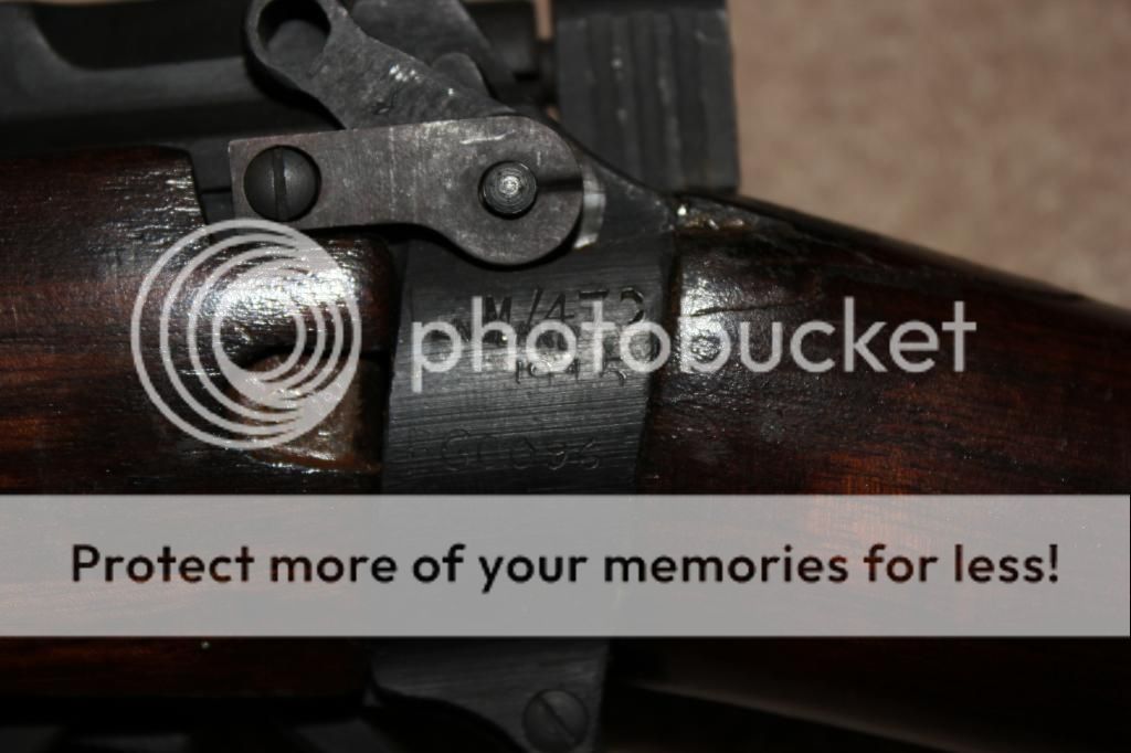

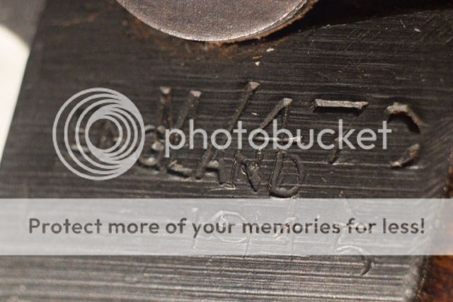

it's a 1945 BSA Shirley, No 5 Mk1 with matching bolt and wrist (receiver).
you can check your magazine for a matching serial, and also under the wood to the forward of the receiver ON the barrel for a matching serial as well. Barrel may be stamped on the left side (non bolt handle side).

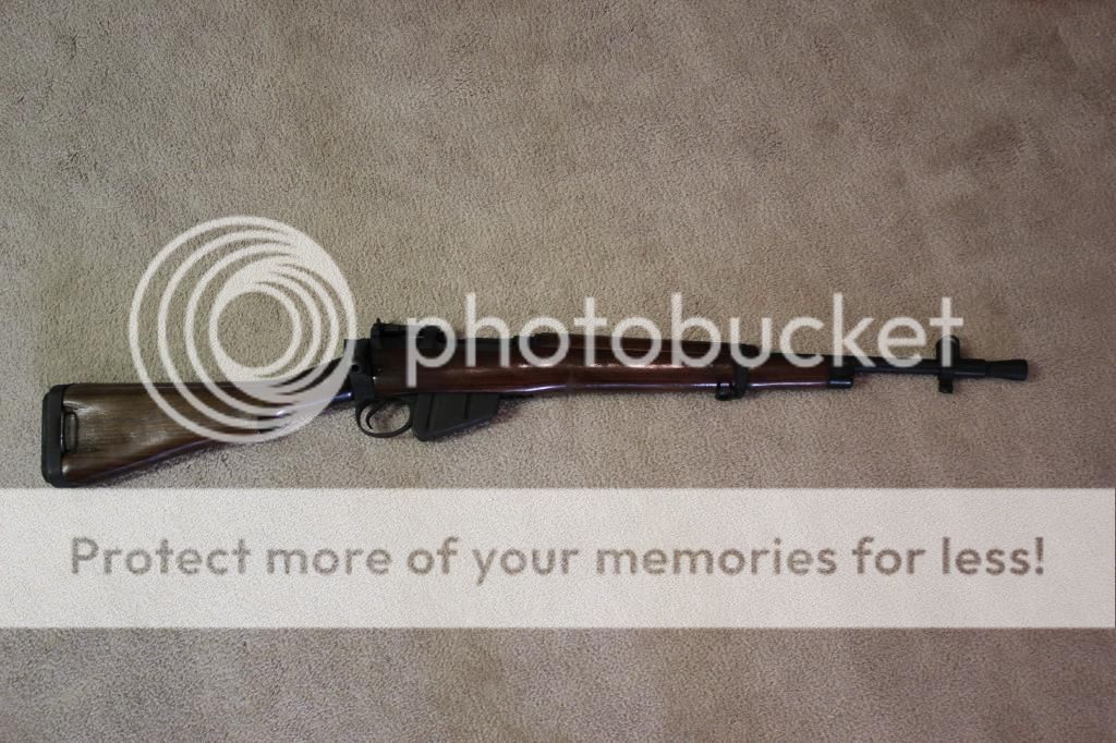

now about that hideous shiny coat shes wearing!!! that cant be right!! can it??
would it be considered a travesty to lightly remove the shiny clear coat and do a nice tung oil treatment? im a wood worker I can be gentle!

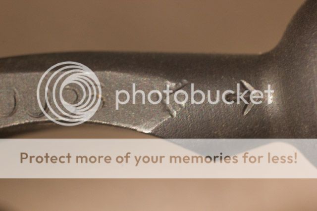

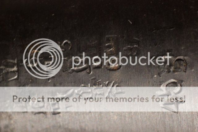

The broad arrow on the bolt is a Brit acceptance mark. The "England" stamp on the butt socket is an export mark after it was sold out of service. As Tungngroove said, it is a BSA. The M/47C is their factory mark. The myriad of small stampings are inspectors marks. You need a book to call them all. The one I can make out, the crown over GR over crossed pendants over P is and England proof mark.

If you're keeping it, go ahead and strip that shine off. You can work it up very nicely using boiled linseed oil. Some good videos online about full strip, steam and refinish using boiled linseed.

As a semi-retired woodworker, my favourite tool for stripping old finish off of gun stocks is the cabinet scraper. Properly used, you can take off old finish without the mess of moisture-based cleaning methods (ie: paint stripper) and get to the wood with minimal damage to any stamps or marks you wish to keep. I have an old and dear Ruger M77 heavy barrel that's been my premiere game-getter over many years. The thick factory stock finish had started to flake and degrade so I finally stripped it all off and did a matte oil finish on the stock. You can go that route, or just use a fine steel wool to dull the shine off the stock. If you choose the steel wool option, take a strong magnet wrapped in linen and pass it over everything. It'll pick up all the fine steel wool residue and when you pull the magnet off the cloth, the fine particulate will mostly just drop off.

All those 'dutch' markings are assorted proof marks. Add the W's. .marstar.ca/html/reflibrary/firearminfo.html
There should be the surplus pre-sale proof marks too. Those are the BNP et al stamps. Required by Brit law on any surplus rifle sold through there.

M47 does mean BSA, and the C narrows it down to their factory at Shirley. (They had others.)
