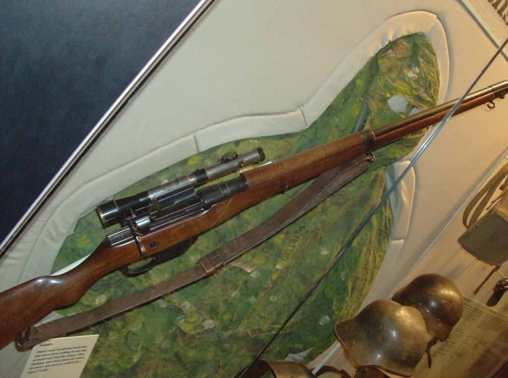

The War Museum in Ottawa has a 1910 Ross sniper rifle on display with a low side mount as shown in one of the pages. I have some poor pictures of the rifle.

The rifle was issued with ONE magazine which was only to be removed for cleaning. An L1A1 or M16 this IS NOT.
for that matter One wonders just WHAT the people in the War office were thinking (or in this case NOT thinking) then they insisted that sniper rifles had to be charger loaded. It also had one other flaw. Armoured plates were sometimes issued for snipers. In order to accomadate the offset scope, the hole in the plate had to be much larger, inviting entrance of an 8mm bullet.
