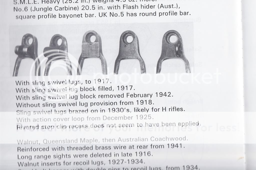

I have a few more waiting for part but early MkIII wood is hard to find and Lithgow wood is like looking for buried treasure. I have a 1913 Lithgow (FTR) that I would like to build soon and a couple of Lithgows 1918 &1917 waiting for fore-stocks. All the numbers match the bolt and receiver but most being ex-sporters don't have the nose numbers matching but are from the proper manufacture. I am always on the look-out for 1914, 1916, and 1919 Lithgows and for the treasures such as a Lithgow trigger guard with a un-milled swivel (1917) and volley sights.
Sounds like me- I've a 1917 Lithgow Mk.III that also needs a fore-end and related parts. While I'd love some lighter coloured wood to match the butt, I'd take any wood I could get at this point. I have managed to find a Lithgow nose-cap, though.
