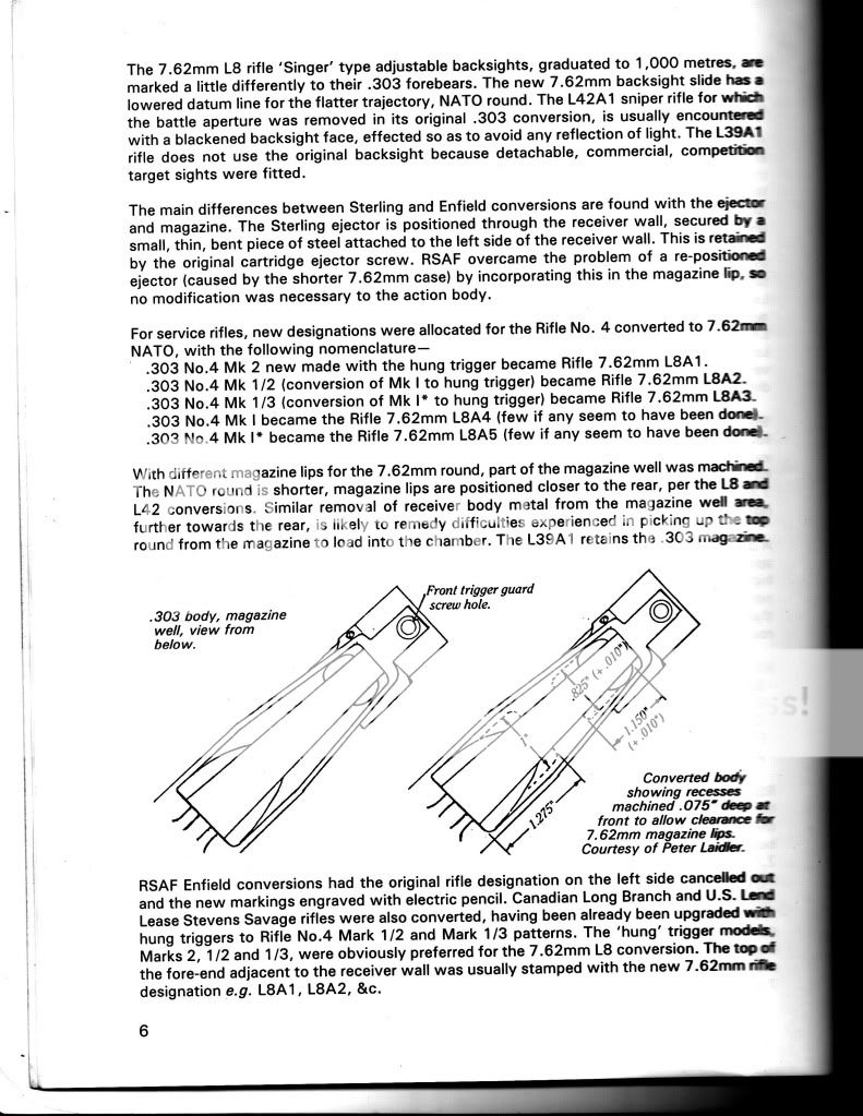

does a 308 magazine fit and function properly in a #4 303 action and floor plate ?
It will work fine if you get a new/used of the following, The underside of the lee enfield action wasn't tapered like a Mauser to feed cartridges. It is tapered to take a 303 mag, the 7.62 cart is smaller on the rim and these mags work within the action space.

The L42 type will require some alteration, see link to get more detail
ht tp://www.milsurps.com/content.php?r=438-7.62mm-factory-magazines-The-L8-and-L42-connection-%28by-Peter-Laidler%29

It is my understanding that Sterling magazines do not require receiver modifications, while L42 magazines might.
There are a couple of other options for .30 conversions - .30/.303 (just the .303 set up for .308 bullets), and .30-40 Krag.
Enfield mags do not need the receiver modification while the Sterling do. The Sterling has no ejector on the magazine and there is a button with spring for the ejector. You have to drill a hole in the receiver just ahead of the current ejector and then use the original ejector as the spring attachment. The sterling ejector will drag on the bolt unless you put a mirror finish on the head and I also found that on some I had to polish the bolt.

This below is what you have to do to get the mag to fit and function right.
