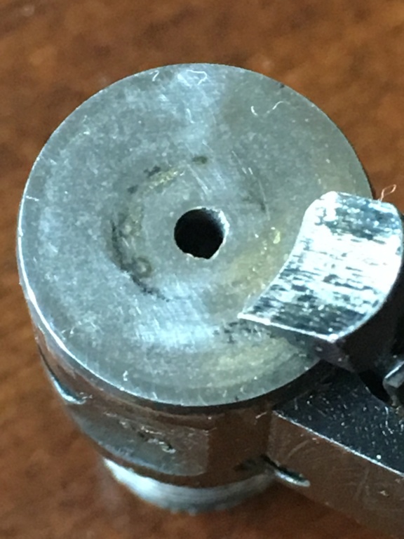

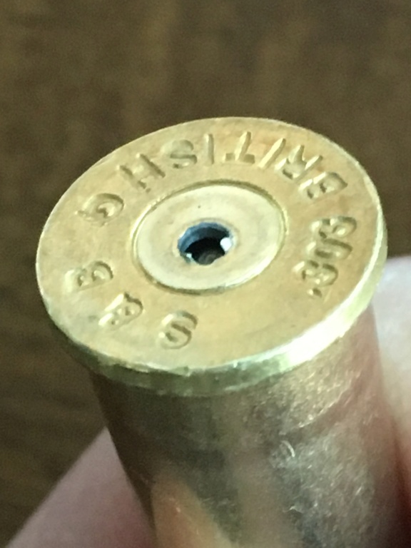

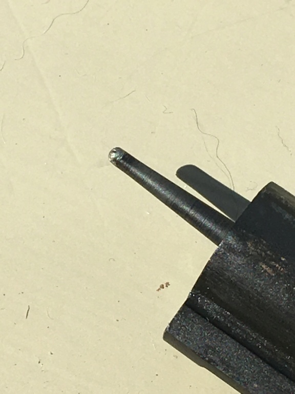

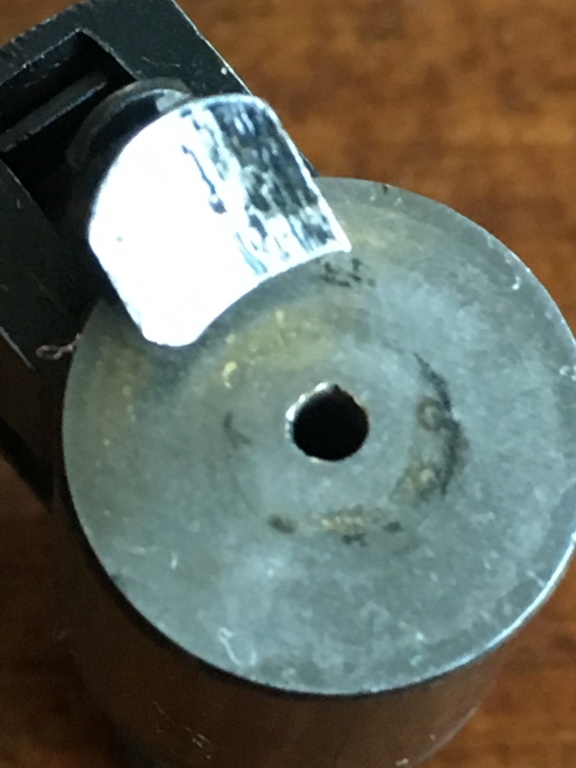

While firing my Long Branch No4 Mk1 I noticed one time it fired differently. It still went bang loudly but this time it was a little different. I inspected the spent casing and noticed the primer strike was more pronounced and deep, I also inspected the bolt head and noticed the firing pin hole no longer looked circular like a portion of the surface was missing. My questions are, what caused this/how do I fix it, is it safe to shoot still with this bolt head and should I replace the bolt head ? I am thinking the bolt head is pooched. Thank you.
elvis3006: What does the tip of the striker look like? Perhaps it is damaged in addition to the bolt-head which could explain the pierced primer. The tip of the striker can be reshaped to the proper profile by stoning but if this were mine I would also replace the bolt-head. You'll need to find one that has near identical critical dimensions to maintain headspace while also giving proper overturn, etc. A trivial matter if you can find a local collector/ gunsmith that has an inventory of bolt-heads to try. To simply try to purchase a single bolt-head without being able to try it in your bolt is not highly likely to work. Try to post a photo of the tip of your striker.
milsurpo
Bolt head is fine to use.
Unscrew it and look at the tip of the firing pin. It should be round. Sometimes a piece breaks off and makes it a spike.
If it is round, carry on shooting.
Stuff happens.

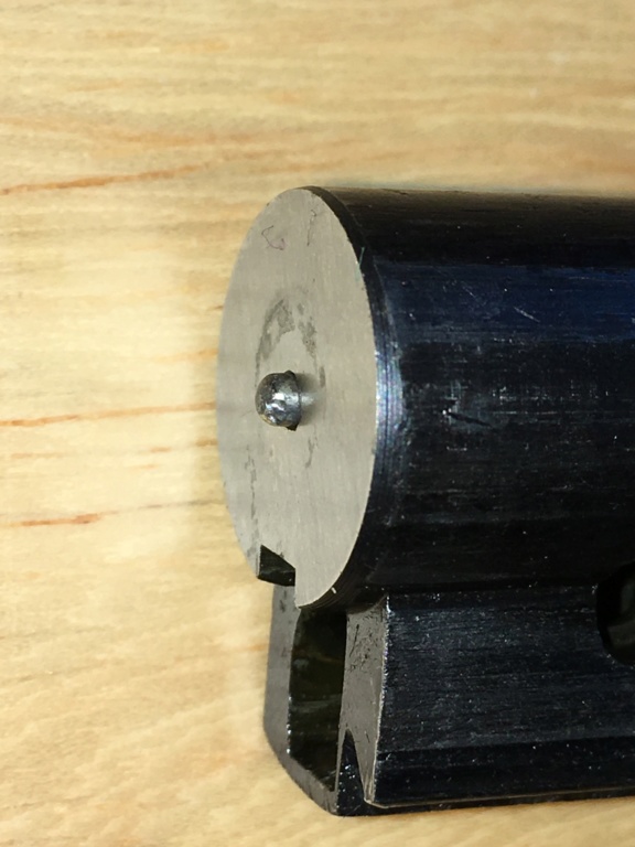

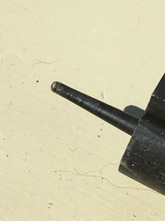

Thanks for the help fellas. Here are two pictures of the striker and one of the cocking piece showing where the firing pin/striker is set at. Also it is a number 1 size bolt head and I have several same sized spares.

the other pictures look OK, perhaps a little cleaning up of the fireing pin.

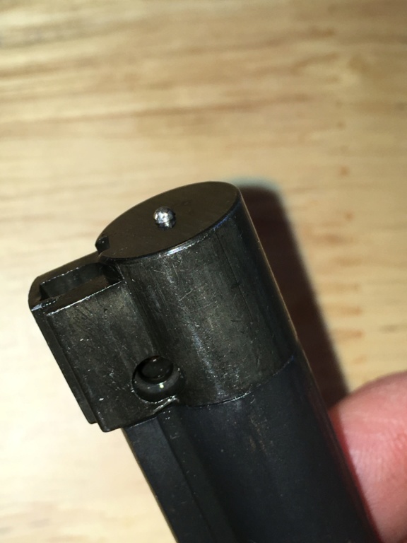

Here you go, first one shows the protrusion of the original number 1 bolt head I experienced the issue and the next pic shows the protrusion on the replacement number 1 bolt head.
Max/min specs on FP protrusion in the No4 are .50/.40.
The firing pin tip should be smoothed up to eliminate the burrs which can cause the primer to be punctured the way it is. It's not a good idea to shoot any rifle when you are experiencing pierced primers.
Looks like it may be a little long.

OK so the firing pin hole on bolt face is still ok despite the gas cuts and safe to use ? Where do you measure bolt head ? And smooth up firing pin and measure its protrusion. Thank you
That pin looks good. Buff it up and you are good to go.
With military primers I have used protrusions as long as 75 thou, but 50 is a good number, assuming the bold head is the correct size.

The 0 bolt head will not screw on to the bolt body all the way and I am not comfortable trying to force it. The best way to ensure it is the proper bolt head size would be to get a 303 headspace no go gauge right ? And I buffed up the firing pin she looks cleaner/smoother.

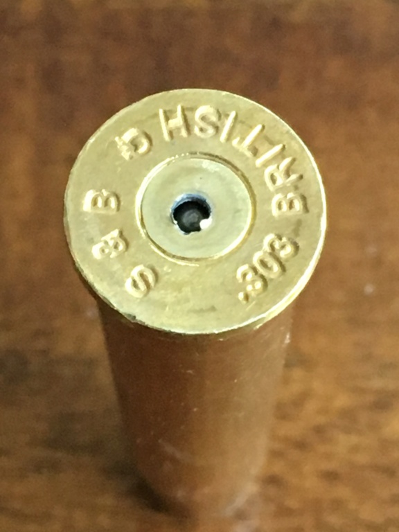

I’ve had the odd pierced primer with S&B .303 Brit, you could definitely hear the difference when they fired. Likely that was th case, I had two in one box and nothing since. None with any other brand of .303 ammo I’ve put through my no4.
The rounds must have been made on a Friday afternoon before closing lol. As Ganderite said I will just carry on thank you for the help everyone.
