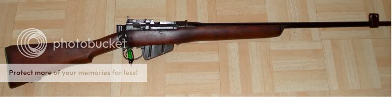

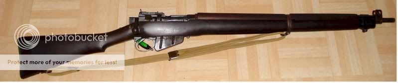

here is a couple pix of 303carbine's Enfield restoration project
Enfield restoration
I got the full wood set from New Mexico off ebay,it took a little finessing to get it to fit properly.I washed it with steel wool and linseed oil,it was cruddy and black and dusty from being in someones attic. It's not a collector item but I'm glad to have it back to full military configuration. Thanks again to Grouseman for putting the pics up.
One more rescued from the clutches of Bubba.........:sniper:
