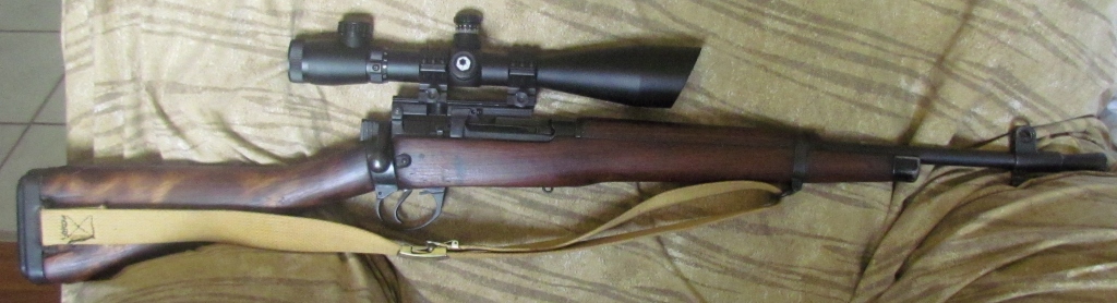

I have this mount.
I have 3 types
The ATI works but will shift after time
The S&K is a great mount . I have it on a No5 carbine . It did shift upwards , but not after 400-500 ( can't remember) rounds. Not bad considering the stout recoil of the No5.
Properly fitted ( real easy ) , the B-Square has never shifted on me what-so-ever, and the 300/600 sight can still be used.
