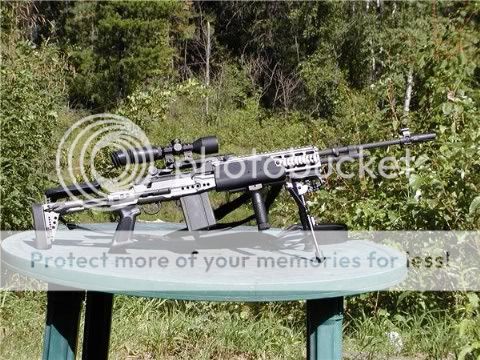

Ive done a few searches to find my answers and Ive wasted about 1hr to try and find the answer but i cant... Just got this one from a member here.... but I have a few questions because im a noob to the m14 platform.
1. On the sage scope mount do I have it mounted in the correct position? And what is the lil grey metal square for? It looks like it goes on the screw on the end of the mount but I cant figure out how to make it sit correctly, so for now I left it off.
2. When he shipped the gun it didn't have the flash hider attached... he included the wrench to hold the barrel and tighten the washer thingy in the hider... but do I need any lock tight or will hand tightening be good enough?
3. How do you attach a vertical foregrip with that hand guard in the way? Or do i have to remove or cut the handguard to install a vertical grip?

Get the vertical grip from sage that screws through the hand guard. it has a fairly long handle and works well as a quick "bipod".
