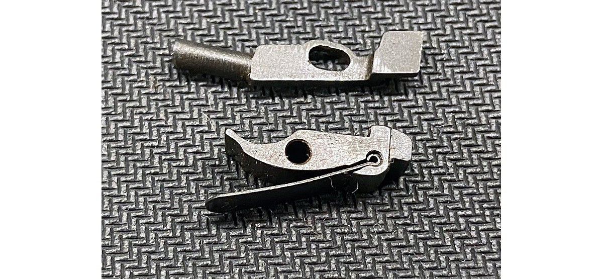

When ever Tok hammer makes unauthorized action, its usually issue with these 2 things in the picture.
Hammer group has to be disassembled and these parts have to be inspected for damage or wear.
Ok awesome thanks everyone! I had cleaned it but not taken the fire control group apart. Looked squeaky clean. Wasn't dirty before as I hadn't run much ammo thru it to be honest. That being said I took it to the range and it double fired on me! So il take it apart and check these things. Then I guess off to a Smith.
