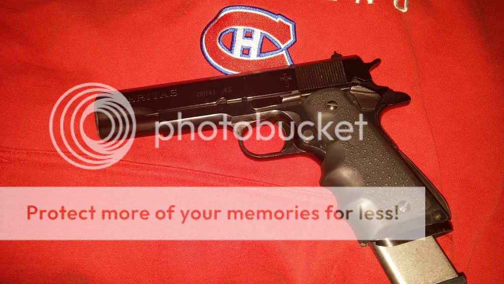

Hey guys, got my first pistol went cheap and got a Norinco. Like the title says I'm having a 3 point jam with every round. Here are the things I've checked based on my google-fu skills.
1) bullet is 230gr FMG Sellier & Bellot.
1) magazine (brand new Remington 7 round) it has the original styled lips.
2) magwell angle at 17.25 deg
3) feed ramp angle at a touch over 31 deg.
4) barrel seat/bridge sitting at .078" from the top of the frame
5) ejector removed and it will go but it is still super "clunky" and not a smooth action whatsoever. I think this may be part of the problem but not the root cause.
Any further help would be glorious and please not the "see a smith"
Thanks in advance.
-MCB
Do you mean Extractor ??
Do you mean you removed the Extractor and it still jams?
re these factory or reloads
Need picture of feed ramp
Ramp could be rough or not angled correctly
could also be other problems
Pictures would be very helpful.
230 grain RN are the easiest to feed so that is probably not an issue.
Is the pistol new ??
Have you tried another magazine ? A bad mag can cause feeding issues and jams.

Ok I'll try to answer everyone in this...
1) The rounds are factory not reloads
2) Yes extractor not ejector (doh!! 2 for tards right?) Yes I've removed the extractor and the issue has persisted. It will feed with a push with the extractor removed.
3) Feed ramp is not rough whatsoever and the angle is correct as per a blueprint I found online. CNCguns.com I think it was.
4) Pistol is used.
5) No haven't tried another magazine.
and here's some pics.
http://s1378.photobucket.com/user/michigancanadianbrett/media/4_zps6fr9lwk2.jpg.html?sort=3&o=0
http://s1378.photobucket.com/user/michigancanadianbrett/media/3_zpspvaowv9d.jpg.html?sort=3&o=1
http://s1378.photobucket.com/user/michigancanadianbrett/media/1_zpsmazb4gjk.jpg.html?sort=3&o=2
