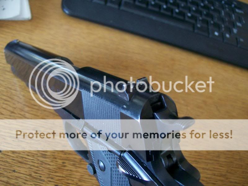

I was recomended this rear sight from another good forum member here.
it will certainly be better than what I have.
http://store01.prostores.com/servlet/fusionfirearms/the-44/Bomar-Style-Match-Sight/Detail
stock rear sight..It has a heavy drift to the left to correct the windage
