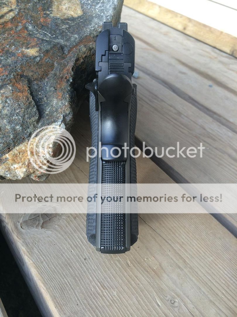

Easy and cheap is buy the Pearce rubber grips that have a 'wasp waist' to them like this and work with regular bushings.

My need for thin grips is that the grips that came with my Norc are custom bubinga Wood Grips and though they fill the hand and really help in controlling the gun, I can't reach the controls, mag release or slide release without tipping/twisting the pistol to the left. With standard Norc grips I still have to break the grip to reach the mag release though less than with the custom. From one range session I know this pistol has great potential. I didn't break 1 second to shot with it yet but it's new to me and it's cold shooting outdoors.
If there aren't slim grips for the Norc or bushings that will fit without being tapped. I may have to just get the slimmest grips I can get that will fit. Slimmer than Norinco standard. I hate those plastic things?
