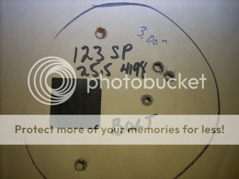

I shot some CZ surplus (the blue box stuff) and some handloads using 125 Hornady SP and IMR4198. This handload has not been developed. The handload did not do very well. I need a better powder, but my shelves have nothing else suitable at the moment. I have to assume I can make better ammo than CZ surplus.

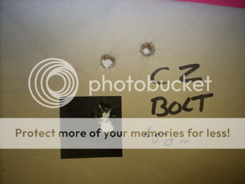

The CZ surplus ammo shot very well. I was aiming at a 1” black patch. The first 3 shots of CZ hit the patch, with one going into the hole of another. Through my spotting scope it looked like I was missing the entire target. It was a big relief when the 4th shot printed just above the patch. The group was 1.5”
The second group with CZ was 2.6”. Still good enough for deer. This ammo grouped 3.3” in my Russian SKS.

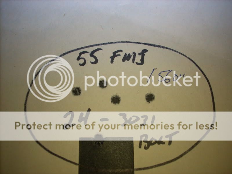

55gr FMJ bullets (factory and handloads) all shot very well. The only 55 FMJ I had with me were the mild loads I use in my M4 for CBQ (very short range), that grouped around 1.5”

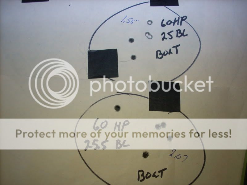

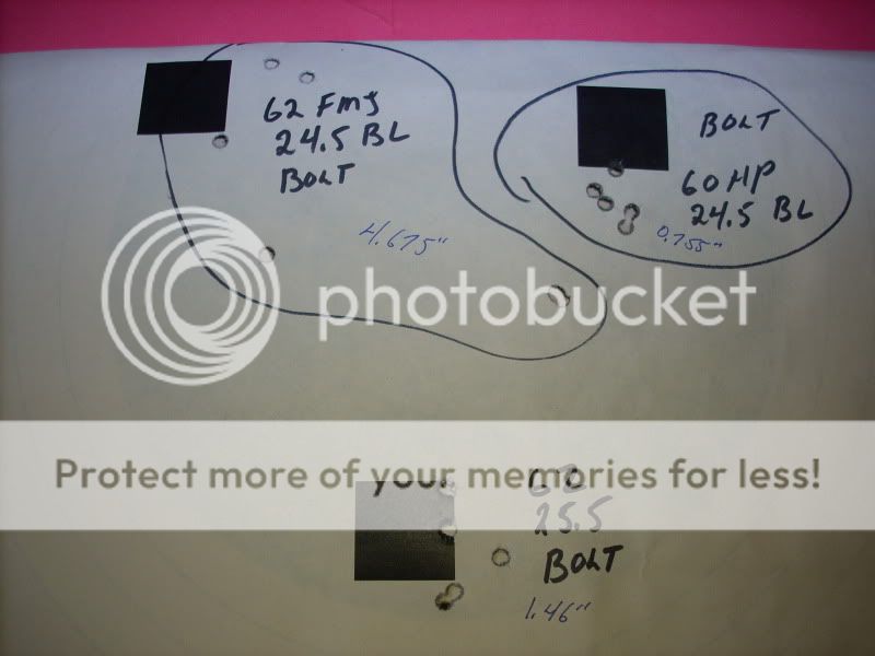

The rifle really likes the Sierra 60 gr HP bullet. Sierra tell me this bullet will work well on a deer. If I was going to use this rifle on game, I would use this one bullet on everything for accuracy, reduced wind drift and game penetration. Groups ran 0.75 to 2.5” with different powder charges.
I have a quantity of 62gr FMJ bullets that do not have the steel penetrator, so they are shorter than the SS109 type bullet. Because they are shorter, they will stabilize – barely. Velocity has to be kept up so as to generate enough RPM. I am hopeful that with the right powder selection I will be able develop a good accurate and cheap load with this bullet.
