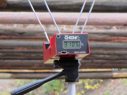

The Norinco ammo is loaded with 25+/-0.2 grains of an unidentified flake propellant. After removing the FMJ bullet I poured the propellant back into the case and seated a 50gr SP bullet. I tried these rounds in my 223 Savage Hog Hunter and Ruger Mini-14 which are completely safe in my particular rifles (can't say these rounds are safe for use in any other rifles
). These chronographed at 3105 fps from my Hog Hunter.

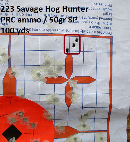

Accuracy is ok. Results as shown.

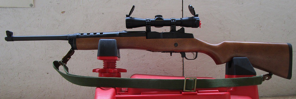

Ruger Mini-14 with Leupold FX-II 4x28mm

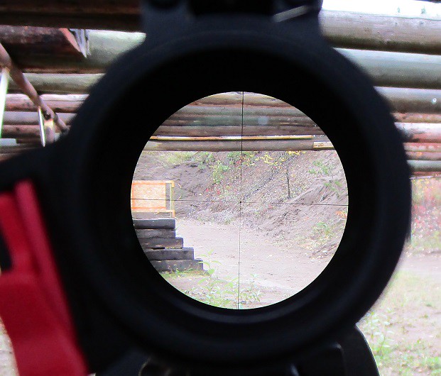

Leupold Dot reticle (fixed 4x)

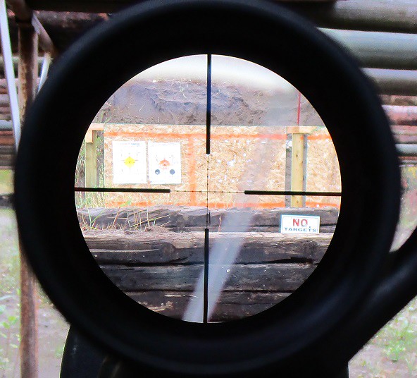

Bushnell Mil Dot reticle (fixed 10x)
