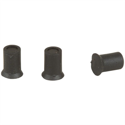

Put a extractor buffer and call it a day. You can buy a upgrade kit for like 20$. Seems like a common issue with the Norc AR15's Ive seen it alot and all fixed by simple extractor buffer.
Money on the extractor and lack of a buffer and making it OVER extend ( opening up due to the recoil,loosing the case). Not because its dirty because guns can go 1000's rds w/o cleaning and not have a issue.
