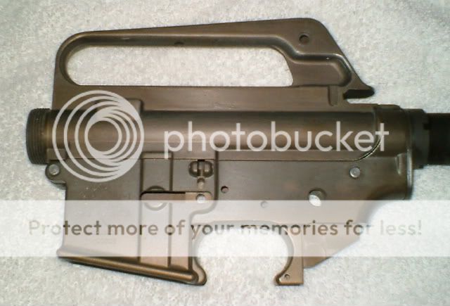

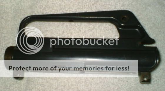

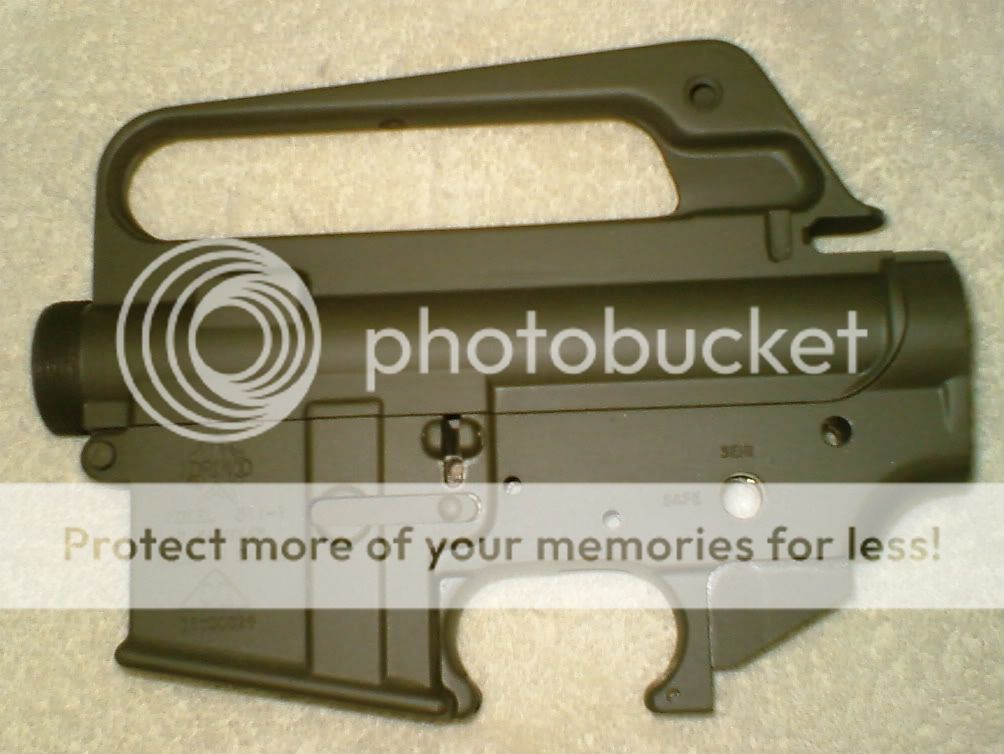

You can't park it. I bad a friend blast the finish off mine, and I airbrushed it with GunKote. GunKote is a Bake on finish, and it turns out well, I was very happy with the result.
The shine you see on the last photo is from Oil I didn't get all wiped off after I baked it.
Finished Gun - I went OD on receiver, and black on barrel and FSB , C/H and Delta ring. I would probable do all OD if I had my time back.
The whole process is too long to go into here, but if you want to go this route, PM me i'll run you thru what I did.
