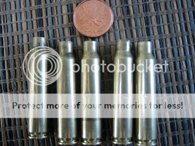

Norinco CQ5.56/M4 dents my brass
jer_vic
11   0   0
BC
I've put about 100 or so rounds through it, and it consistently puts a small dent in every case. I looked in the chamber, and there doesn't appear to be anything stuck on the side of it that would cause this (but it was kinda hard to see clearly). I did scrub it out with a little plastic brush.
Also, I've chambered and ejected a round without firing it, and it came out dent free.
Is the empty brass hitting something on the way out maybe?
I want to reload, but I'm not thrilled about the dents. My father (who used to reload a lot, many years ago) thought it wasn't anything to be concerned about and the dents would fire form out.
Any ideas, suggestions?
I'm at work, but will post some pictures later tonight from home.
Edit: Here's the pic:
Where is the dent?
My bolt leaves a dent on the mouth itself from the spent casing hitting the side of the action as it is being ejected. I put pressure on the case as I extract it to prevent the contact. Obviously with a semi that wont work

Probly the deflector IMHO.

I notice the same thing with mine also the brass ejects forward at about the 2 oclock postion.
Mine ejects the same way - forward of the firing line, about 2 o'clock.
Thanks to all the replies. Was at the range last night, and it was indeed the deflector.
