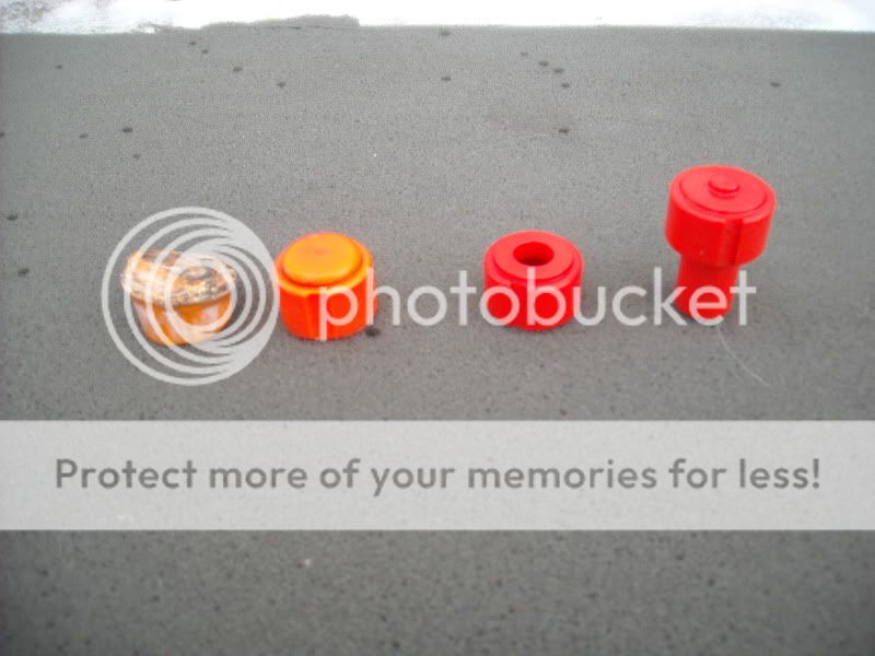

First off ours will not melt when you use bore cleaner, ill dig up the photo of the test I did in 2006 .
put a rem factory ,S&J and nork follwer is a container and sprayed then down with brake cleaner.
NOT GOOD!!!
Nork melted ito a pile of goop the Remington one split and cracked ours was un touched.
ours are CNC milled from solid derlin not plastic, they will not crack do not need to be lubed and will not melt if you use cleaner.
They are also very well made and a bright green
At some point this year we will hit 50,000 sold.
