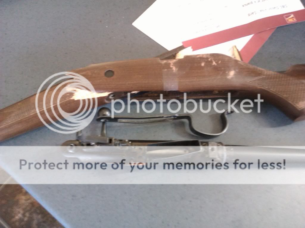

I see a broken stock, but the barrel, action and bolt appear to be together, what happened there? It looks like the stock was just busted, but you seem to be indicating it blew up.
Thank #### they're still together. Otherwise I might of been a lot worse off then a few little cuts.
