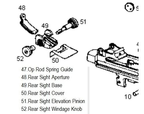

I am attempting to "zero" my gun in. Ive done lots of research on this and have it all printed out and stuffed into my ammo bag for reading at the bench when im trying to get the gun zeroed. Elevation seems to work FINE. Windage is my problem. From memory it was 72 clicks and 16 either side of zero for windage , and this is true, I confirmed that much.
The left knob, the elevation, rotates with ease likly as it should. The windage does NOT rotate with ease- sometimes it rotates other times it wont move a at all, in either direction. When it does rotate it not only adjusts the windage but it often moves the elevation up or down with it (!).
When moving the windage to the left I also find that it starts to unscrew itself becoming "loose". Turning it right tightens it back up. My temporary solution for this was to crank the thing hard left, tighten it up by screw driver, then move it 16 clicks to the right until it was in the dead middle- where I needed it to try to "zero" the gun.
My plan is to never ever ever ever bother touching the windage again and simply adjust the front sight for this.
Is this normal? I'd assume the windage should work as easily as the elevation, rotate freely without loosening things and always with noticeable "clicks". Sadly for me this is not the case- that windage side of the rear sights has some issues.
thoughts?

Problem:
thoughts?
