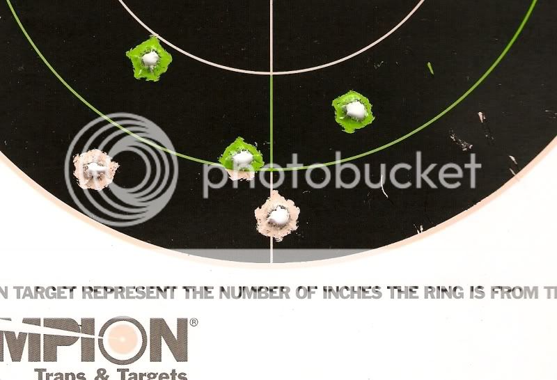

After having my Norinco M14 "touched" by Hungry at the Eastern Ontario clinic a few weeks ago I finally took it out to the range today with a fellow CGN'er.
With the shims installed, properly lubed up, and trigger smoothed out (while watching a Sens game ;-) I was able to shoot a few 2-3" 5-shot groups at 100 meters with my handloads (168HPBT over 42.5 gr of IMR4895, FL re-sized of course ;-).
Not bad for open sights (NM front post, Norinco rear sight) and using my pack as a rest.
I am sure that this rifle will shoot better...need to practice more and will also tune these hand loads a bit more.

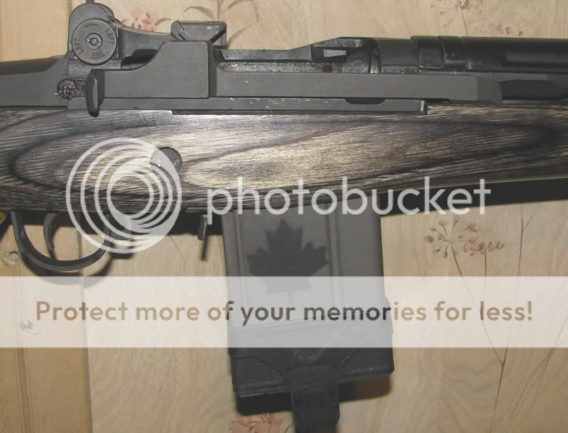

Outstanding. That is a gorgeous stock. I am hoping one day to get mine over to see "THE MAN". He's a big help but pm's don't seem to have the same effect lmao.
that load is the max load in my lyman book, try working down in .5gr incremints and see if that helps with group size, i found 150gr fmj 41.5gr imr4895 will shoot 1.5moa in my m14,
beautiful stock
Very nice TomZ!!! Very nice!!!
Love the pepper laminate!!! Damn ###y looking stock!

Report back after you've fired a few hundred more rounds. These rifles need to be worked in before they'll show their proper potential.

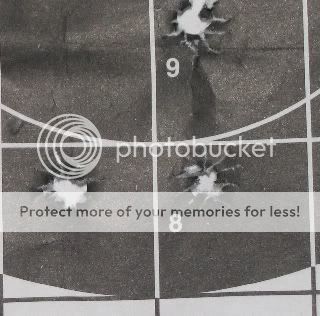

Man, can these rifles shoot! Here is my best 3-shot group from this morning. Open sights, on a bench with my pack as a rest. Same handload as before.
Just over 1.3"!
I believe the biggest improvement since the Clinic was in the trigger pull. I worked on it as recommended and it is much smoother! I am also leaning to hold it just before it breaks.
TomZ
